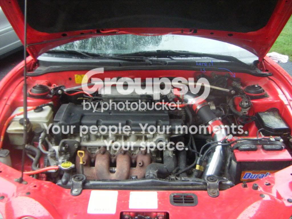

Ok thanks tanc. Ill make sure to check that. Would you mind describing to me where I can check this level?

Are you serious? Oh man, you need to learn to check your fluids. The reservoir is near the brake booster. Check for leaks along the line to the actuator. The actuator is located on top of the tranny. Have someone press the clutch and watch the arm move. If it doesn't extend much, its time for a rebuild of the piston.

to make it simple, its a little resevoir at the back on the drivers side of the engine bay, the arm is on top of the tranny just the the left of the battery

Old Dec 21, 2008 | 05:13 PM
stealth's Avatar
Posts: 786
From: South Dakota
Vehicle: 2000/Hyundai/Tiburon
lol, i was too lazy to post a pic

Yeah i saw which one it was when I went out to the car. Thanks guys. I found out what happened too. The seal broke on the actuator thing. So I need to get a new one of those. ...yay me...
