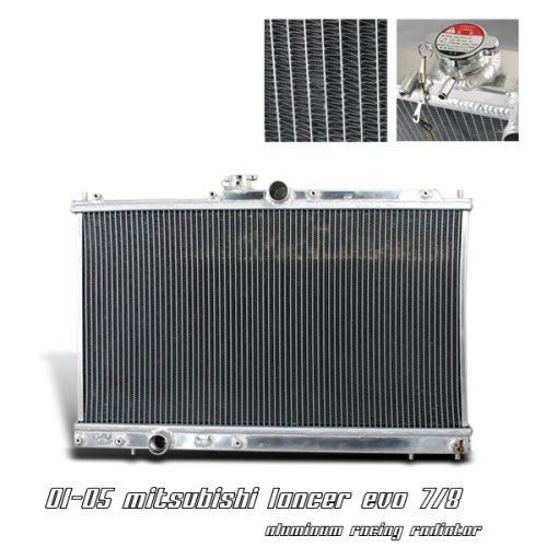

you think a radiator from an evolution will be ok?

^$165 price difference between the evo and the koyo. the inlets are 4mm apart, dimensions are the same, and core dimensions are the same. only thing left is the cap. i hope it's ok, and it doesn't have anything to do with a turbo. hmmm....

If your saying you could get the all aluminum evo for about $150 I would try it. If it works out then it would give the community another great option. The hoses should all hook up pretty easily with no modification with the exception of the overflow which would be an easy and cheap replacement of 3/8" rubber hose. The other issue would be the mounts on the bottom. Ares just slide in place and I am not sure how the aluminum one would mount. You could easily fix that too I would think.

capn tibs, that's crazy, i've never heard of our fans doing that but i guess that would tear into the radiator. sounds like my aem hitting battery terminal story!! and yeah you are right about the mounts. i've got that thought out, and will simply extend the overfill hose.
