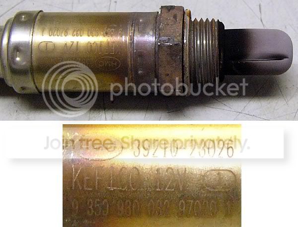

Here's the old sensor. When I pulled it out, my comment was "Man, that's running lean as (deleted)!" which of course is what the ECM thinks also. Cross your fingers and we'll see if this is the problem. Good news: the car started and didn't idle like poopy when I had installed the new (to this car) sensor. I reset the CEL and we'll see what happens.

A busted turn signal prevents me getting my car inspected but the CEL stayed away for good. Call this P1128 O2 sensor-related.
