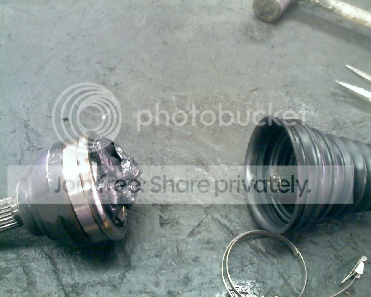

Ok, so I busted a CV boot. I tried to replace the boot today by removing the CV joint, putting on the new boot, then putting the CV joint back together.
Things went wrong when the joint kept popping out when I was putting the axel back together. It would pop out, then I'd smack it back in, it would do the same again, so I'd smack it back in harder with the hammer. I removed it completely, then got a visual while I smacked it in place. I don't know why It's popping off.
Anyone with experience please help me out. I need to know how to get that little clip to hold the CV in place. What am I doing wrong?

ok, so there's no notches or anything on it? It must have not made a good connection. it felt like it did, but i guess not.. I'll grease it up and try again.
^^That could have been the problem..
Just an update.. The shop shut down for their weekend on tuesday and wednessday. I worked durring the hours they were opened on monday and I didn't have time to work on my car. For the first time I had my car towed, it was sad. The dealership covered the repair under warranty and I ended up with a new axle. I would have done the repair myself so that I didn't have to wait, but the shop closed down. They said when the axle popped out from the CV joint, it stripped the end of the axle.
That could be the reason that Hyundai just installs new axels insted of re-greasing and re-booting.
