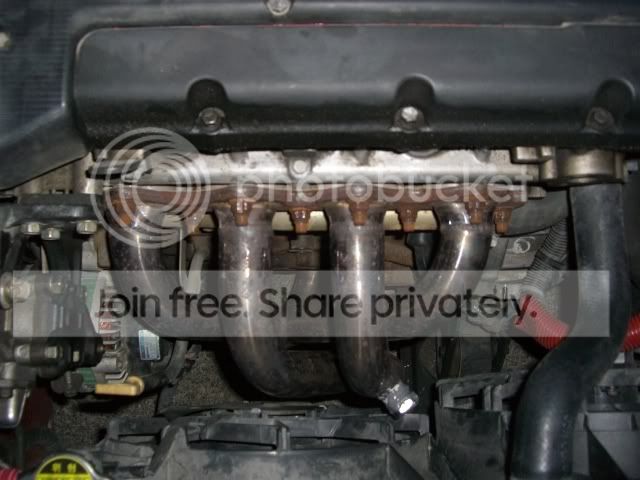

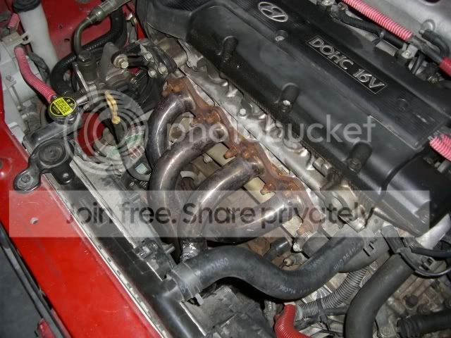

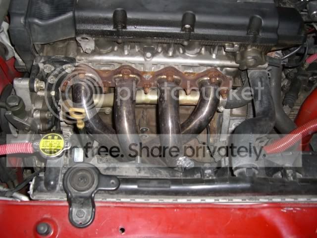

i finally got the header i bought from KAW installed. there is an o2 bung on one of the runners so i bought a bolt and used JB weld to keep it in there. well, i was driving down the highway earlier this afternoon and the bolt came out. i got home and put the other part of the bolt in and used quite a bit more JB weld this time, hopefully it'll hold. i noticed a considerable change in the responsiveness of the car. now i just need to get a highflow cat and custom cat-back made up. here are some pictures...

i took the header off today during lunch and had the welders at work plug the o2 bung on the runner. i still need to grind it down a little to make it flush, but it's sealed now and working fine.
