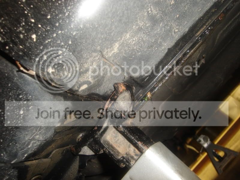

This always confuses me, do I put the jackstand here...
Or do I put it here...
The second one just seems to be beckoning for the stand to be put there...

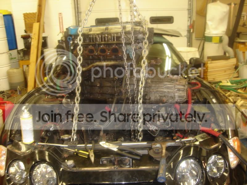

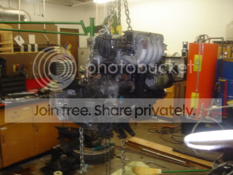

The engine is free...
and now out of the car completely...

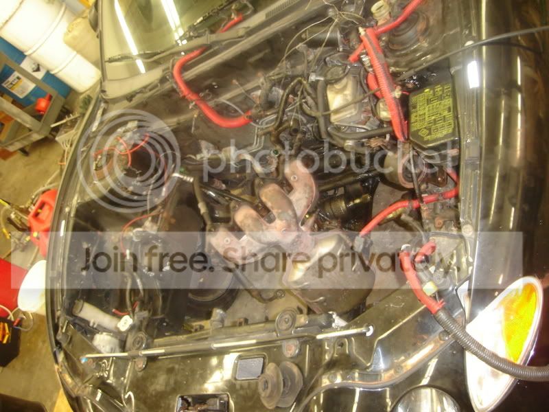

And here is the engine bay, sans engine. I'm going to have to remove the headers & cat, but I had a tough time with the rusted nuts, and I thought it'd be easier after I pulled the engine. We'll see how that goes...

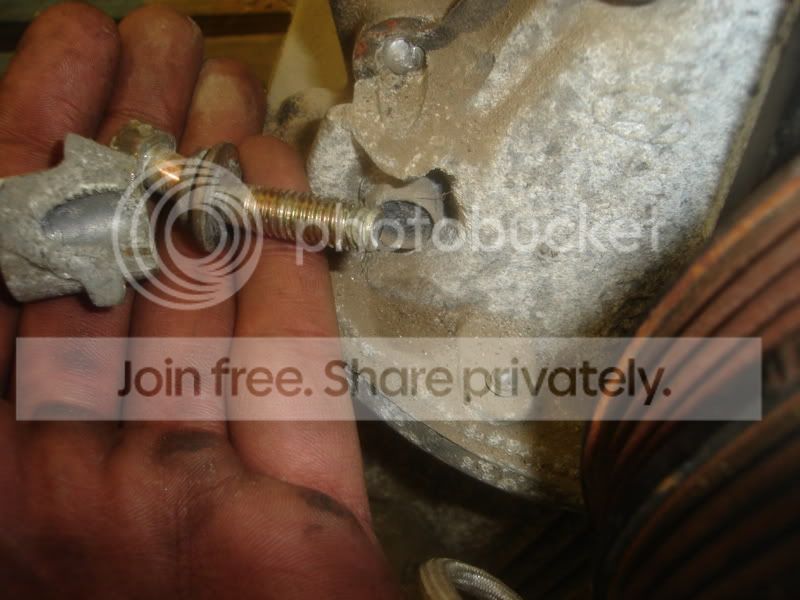

So I started pulling off parts from the old engine in preparation for installation on the new. Thats when I discovered that one of the mounts for the AC belt tensioner on the new engine is snapped. Looks like they rested the engine on it... The mount is broken and half a bolt snapped into whats left... Going to have to contact the yard about this I think. I don't know if it'll be alright with just one bolt holding it in, so I'd like to have it drilled out and get a helicoil in there.

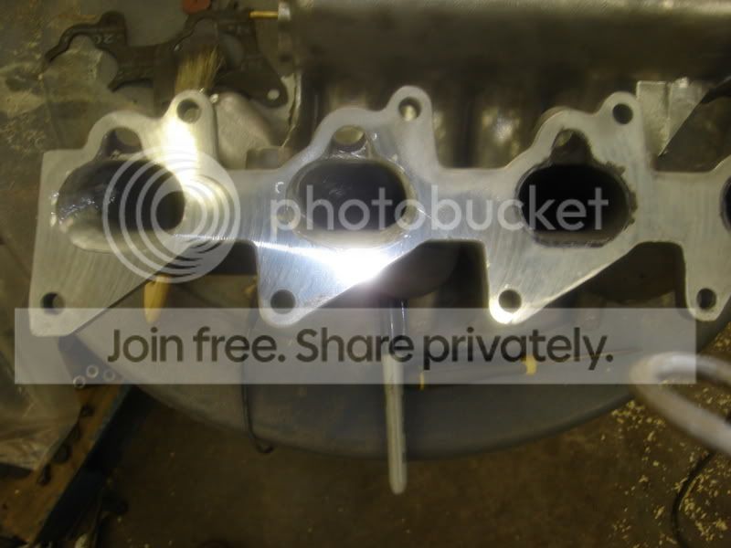

I also cleaned up and ported the IM. Not planning on boring it though... cleaning it up and porting it already took way too much time!! And I don't plan on getting a BBTB anytime soon...

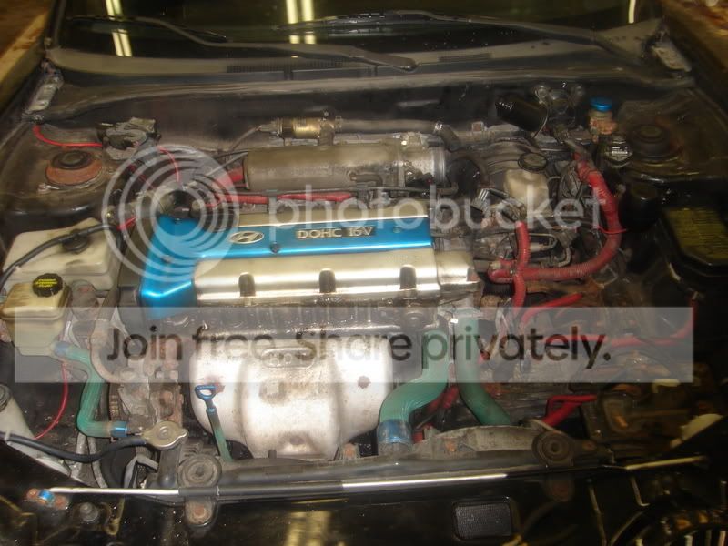

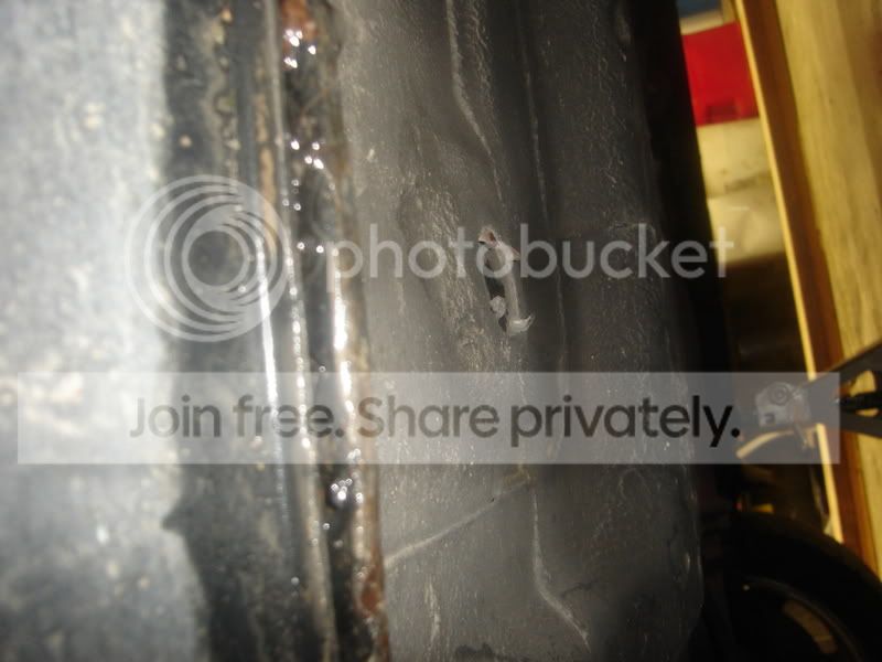

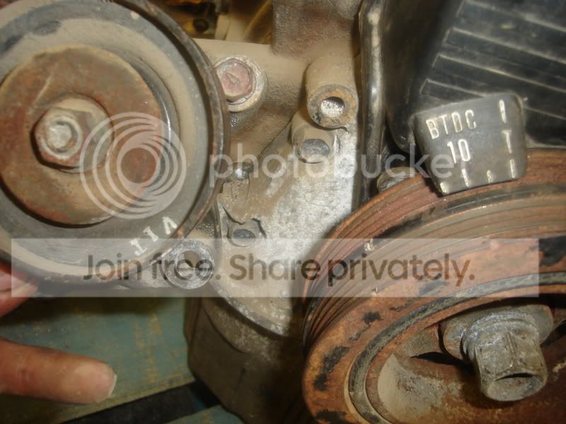

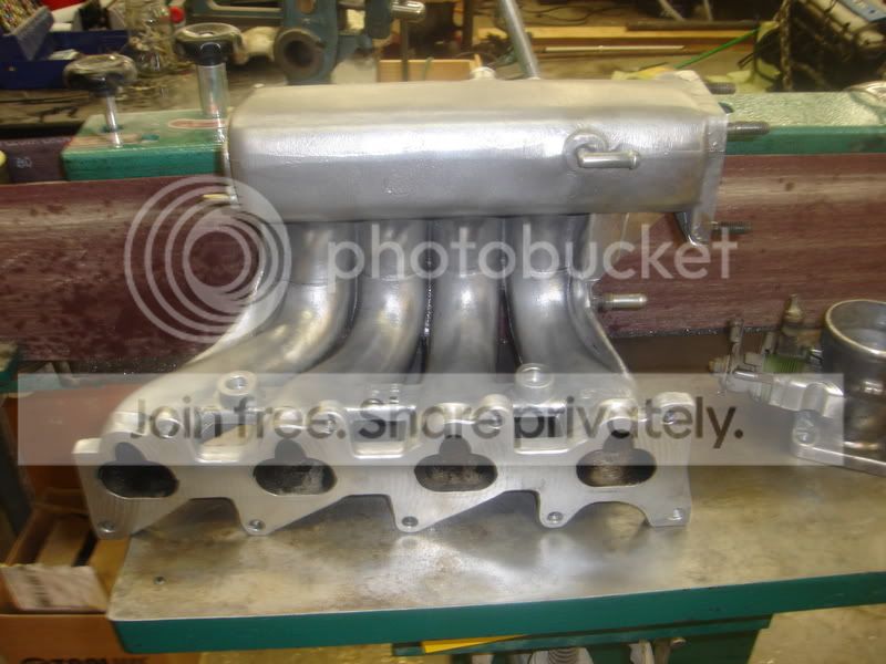

Here is what I started with, (already removed the MAF & Intake)
