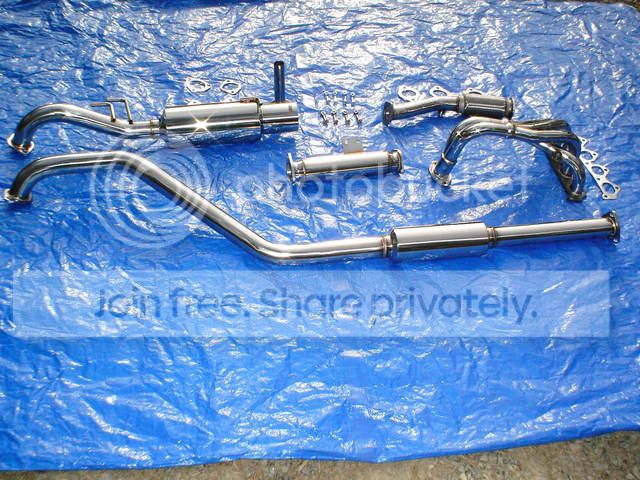

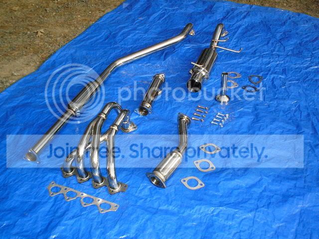

Mate... I saw the SSA full "engine back" system that OP was talking about on e-bay for like US$425.00!!
Here's a pic (if I can find the link I'll post that too)
Looks pretty sweet & if I were living in the states I'd probably get that...
I've heard fitment with SSA can sometimes be a bit of an issue but the package comes with header, flex-pipe, test cat (which you replace with a high flow cat) & madrel-bent cat-back with resonator & a decent looking muffler!
blu, if I were you, I'd take a chance with it... If there are any left! wink.gif
Here's a better shot of the header

Default Re: For the RD2 Lovers.
What's that little pipe in the middle for? When I got my KRD it didn't have that.

EDIT: oops, thought you were talking in the middle of the pipe. Should've known you weren't that stupid. lol.gif
Looks to be the test pipe.
