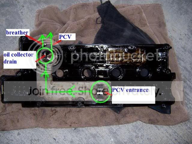

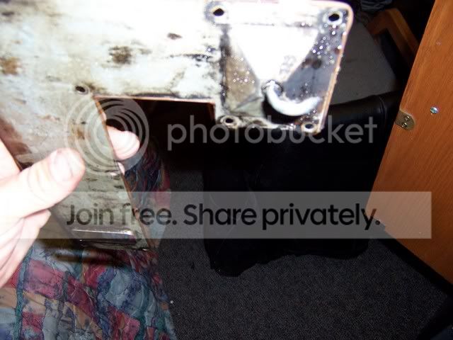

well, i pulled off my valve cover, pulled out the screws on that metal separator and found some buildup inside that little U tube/ tray asembly by the pcv/breather. is it possible that tube was filled up and basically acting like a venturi for the oil through the breather?
no need. my PCV is clean, it's the engine's INTERNAL catch can that was failing. I'll write up a DIY on this soon enough.
I've troubleshot the problem.
Because the drain was clogged, the oil was pooling up and finding it's way into my intake. All oil vapor was collecting and being shot into the intake. Which explains alot of the problems i've been having.

^^ You may be right, but I believe the blast from blowing up my freakin' intake with nitrous may have burned up some oil, forced particals into my breather and clogged up my PCV oil drain. I did a DIY on how to clean the beta engine's internal catch can. http://www.rdtiburon.com/index.php?showtop...mp;#entry309954

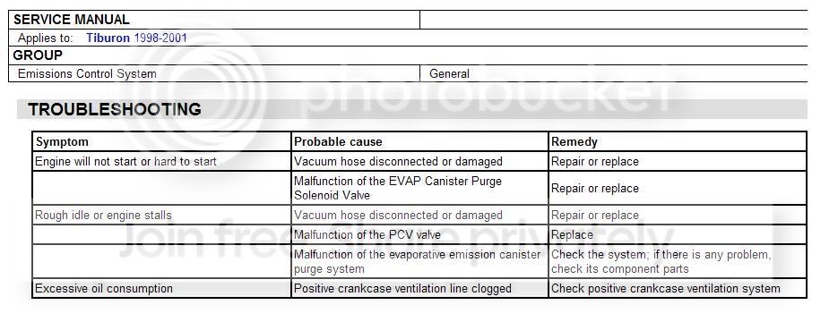

Hyundai lists clogged PCV line as a possible cause for excessive oil consumption. I found some burned up black crud blocking the PCV oil drain.
