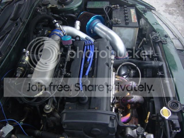

Hi... I want to know the purpose of the black hose connected from the engine to the Intake Manifold?? there are 2 coming out from the engine, one beside the other. One of them is connected to the Intake.... I put a breather there.... but the other???
If I take out that house and put another "mini air filter" breather, could be a problem???
this is the image:
Thanks....

If you put a breather filter on the hose coming from the elbow.. you will have a boost leak
stick a bolt into that hose and clamp it down
You should consider getting a catch can.

Ok.. on the conection of the Intake manifold, I was thinking on conecting the vacumm line of the BOV. And the conection came from the engine (to the IM) I will put a filter.
Could I do that without harming something??
