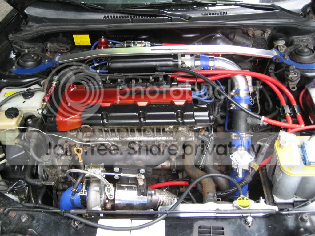

You can swap over the other valve cover.. As long as the beta II is non-CVVT (I doubt it is, those are 2003+ I think)
I have a beta II cover on my beta I engine:
Just make sure to go light on tightening the bolts, it cracks easily.
