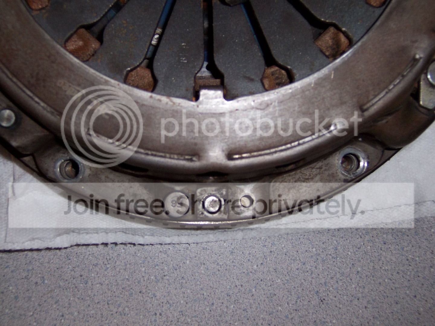

2. Yes, but, the pressure plate, not the flywheel. The pressure plate has 9 holes in it, the flywheel has 3 studs and 6 threaded holes. There's a total of 3 out of 9 positions it will fit properly. I rotated it twice and figured the new flywheel was designed to mount with just 3 bolts instead of 6. After cleaning up and playing with my stock flywheel at home I realized I had made a blunder.

Here's some more pictures of my cleaned up clutch and flywheel assembly. It's seriously as clean as it gets. It soaked in hot dawn after the parts cleaner. and was scrubbed with a brush so that I could handle it and in case of emergency reuse any part necessary.
Picture showing proper orientation of the pressure plate on the flywheel
Picture showing worn/glazed clutch. If you look up at the top portion of this picture, you can see that the clutch actually changed color under the heat. It started off as a somewhat purple color.
