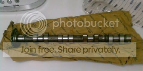

Now, below is a picture of a 1.8 camshaft that i had as a spare - please can someone confirm if thats the same firing order as you guys have got? As these go plonk straight in our engine, and are the correct firing order.

oh - anothwr thing - just to double check: please could you confirm to me that the pic of the cam above has the same firing order of yours - or what your firing order is?
Weird, because the ones supplied had the firing order of 1,3,4,2 which *should* be correct according to everyone - but somehow it just isnt!

QUOTE (Androoo @ Oct 17 2008, 04:20 AM)
The cam pictured looks like 1, 3, 4, 2 to me. As it's pictured (backwards from how it's in the motor), it spins away from me... so 1, 3, 4, 2 looks right.
Post a pic of the one out your engine that's supposedly 1, 2, 4, 3.

Ok, i think we have it.....
You will have to excuse my sloppy way of describing it but anyhow....
Yeah, i8acoba, youre right, the coupe does actually have a firing order of 1,3,4,2. But, the cams that were sent weren't
A possible cause may be that some left hand drive hyundais Sonata. etc - when they are left hand drive, the engine positioning switches - ie its made to a mirror image to fit a LHD car - or similly RHD whichever way you want to look.
Now, looking at the catcams - the would work, in a firing order of 1,3,4,2 IF you rotate the cams the other way around! Ie, i think that when they were made (perhaps these were the first 2 in the batch, and the lobes base form was contructed, they thought the coupe had indeed the same type of engine - switched. But, as it doesnt, a mistake was made and sadly they were put back on the shelf, and left for a couple of years. So when Aaron and I came along looking for 2 pairs of cams, they remembered "ah, yes we have 2" but infact were just essentially cock-ups.
So.... they have been sent back, and Belgium are now making another batch over the next few weeks, with a set of OEM cams so they DEFINATELY cant get it wrong this time.
