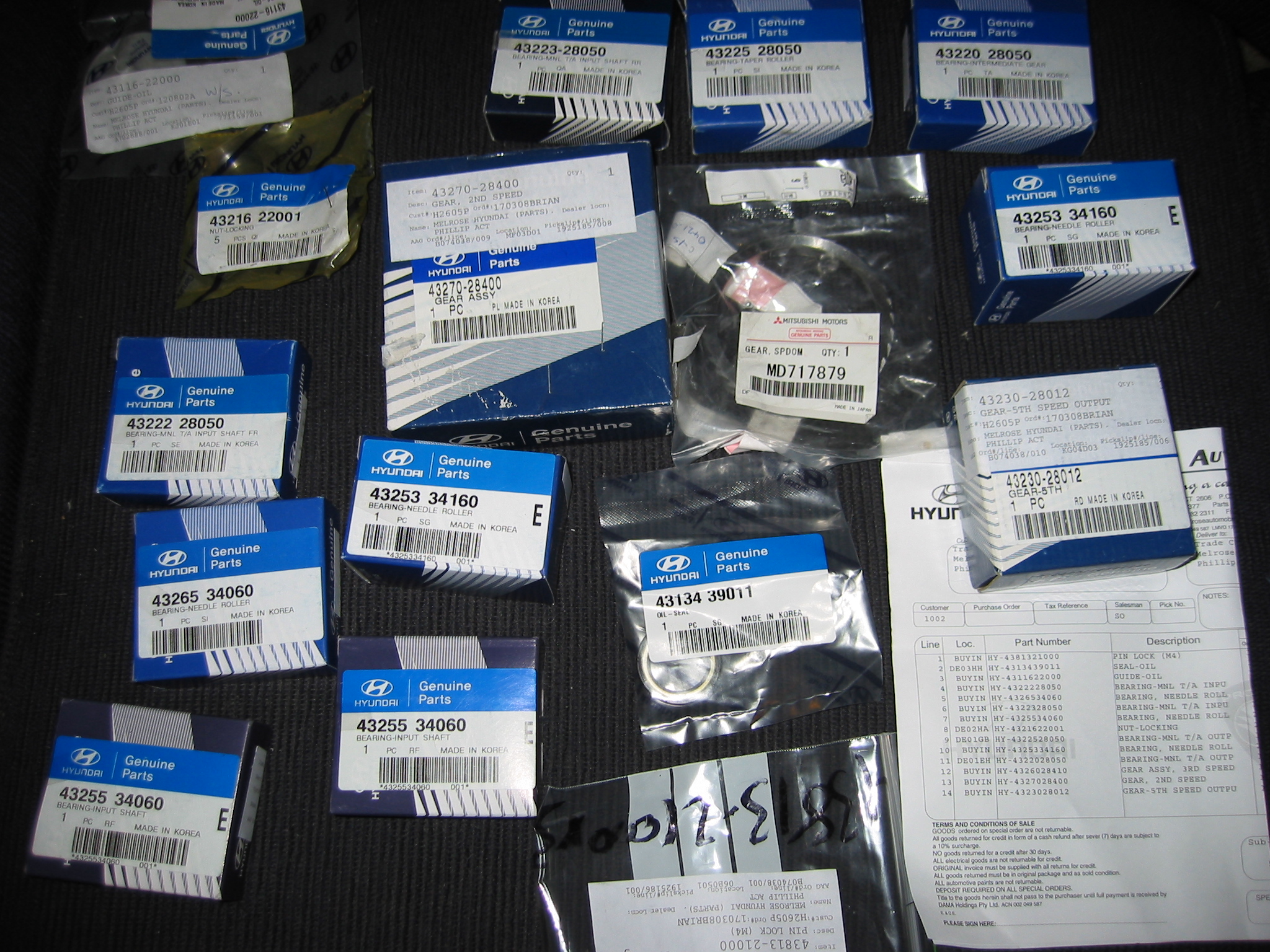

parts parts and more parts
no 3rd gear in country, need to order from korea, another 2 weeks..
