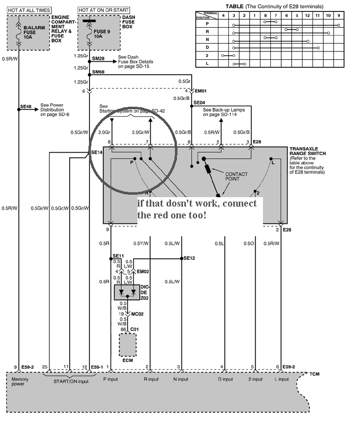

Found this on webtech... Did you do this yet? This will simulate the car always being in park. It is also the way the stock manual system is hooked up. You need to jumper the 2 wires.

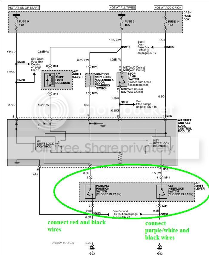

I found another one, but I'm not completely sure about it. it goes to the ECM so basically it comes from the park signal and goes into the mysterious black box....

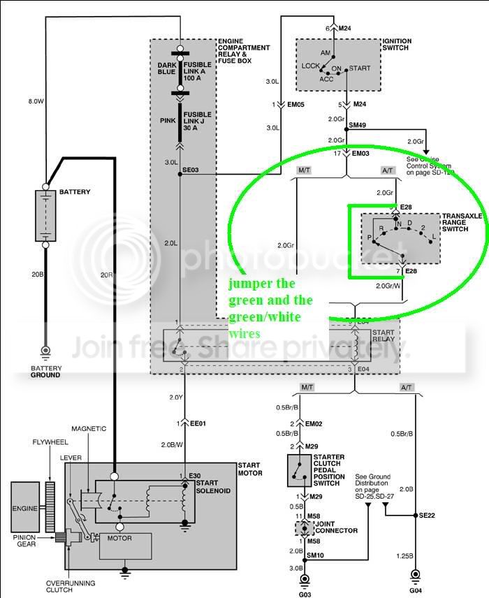

I found one more! This looks like it will cure your problems.

Thanks for the info DTN. I'll look into it to see if that was the problem. For the fix now, we just took the spring out that locks the key into that position in the column so I can take the key out anytime I want even when driving since it thinks it locks but doesn't actually move the part.
