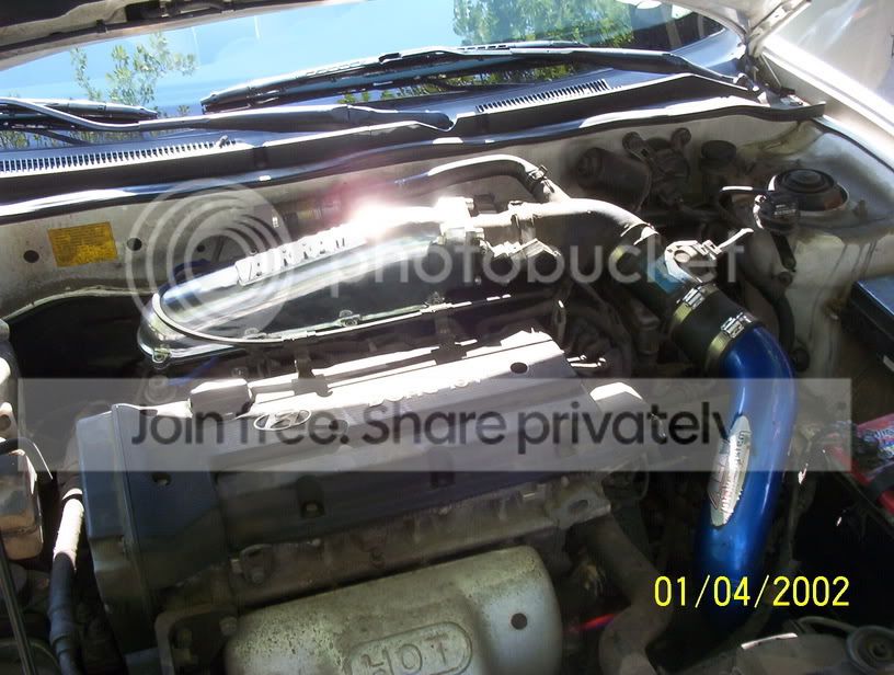

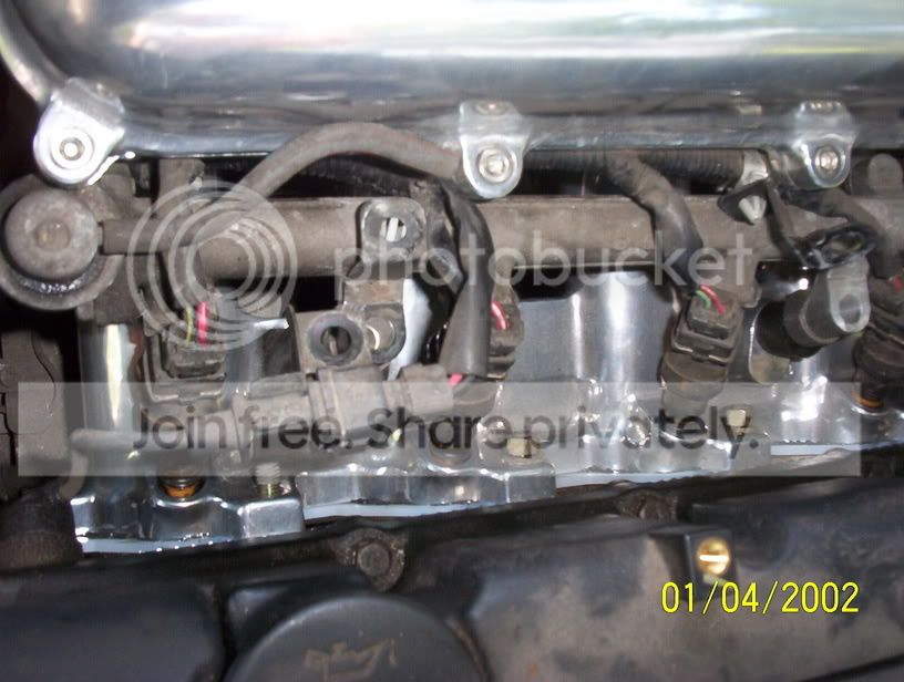

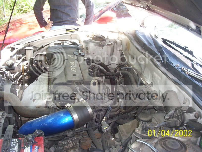

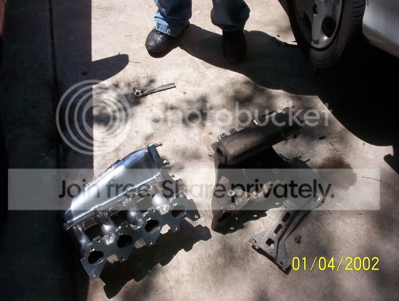

ok, i installed Screwdriver's airram intake manifold yesterday. ran into a few things that even with us searching, had really never been brought up. so im making this post to try to help out future airram installs. 1st, you are going to need to by some hoses because the airram has them all relocated to different areas. so the stock ones will not work.
you will need.
2 feet of 3/4 inch hose. we just got heater hose because its just a vaccum line, so the heater hose will be fine.
2 feet of high pressure fuel injection 5/16ths hose. this is for the fuel lines to the throttle body.
2 feet of 1/4 inch hose for the vacuum line off the fuel pressure regulator.
this all has sum extra left over, but u buy it by the foot, and thats how much was needed to cover it.
from reading other posts, many people say its a hard install. im going to dis-agree, it was very straight forward. if you have the tools. id say go for it.

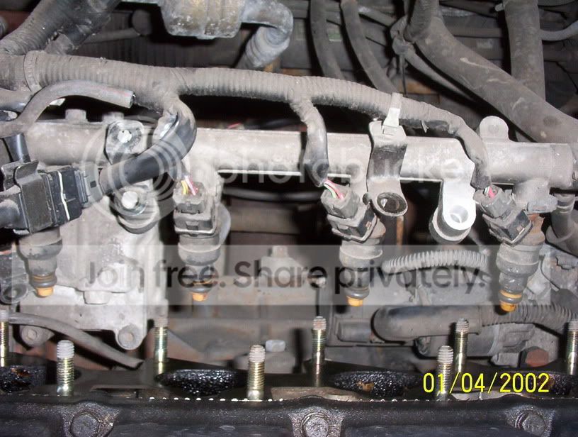

you dont need to unhook your fuel rail at all, just unbolt it from the stock intake manifold, and leave all fuel lines attatched, made it alot easier also.

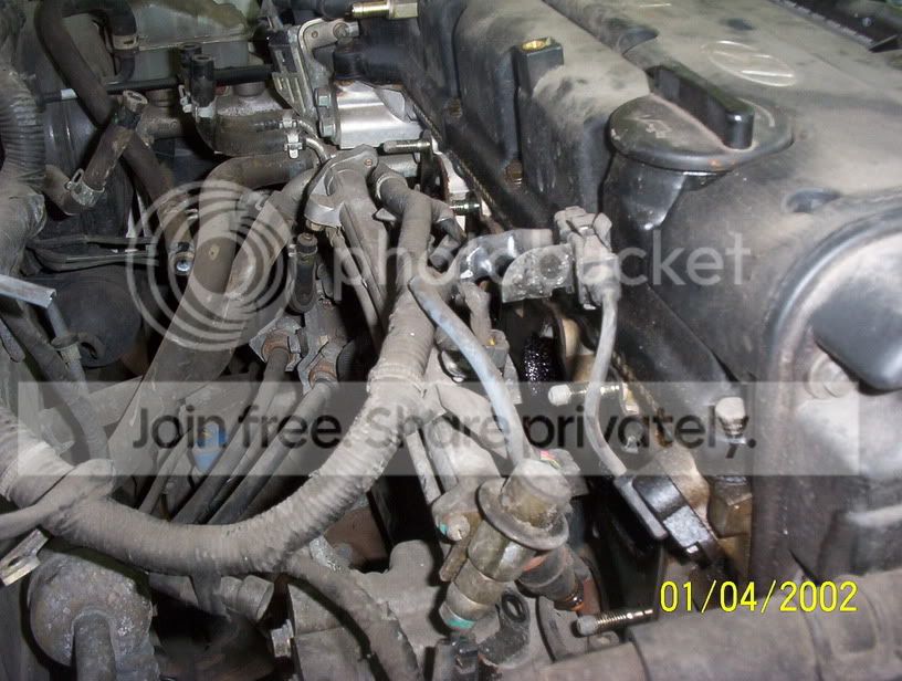

the one main issues i had was the thing on the rear of the intake manifold, im not exactly sure what it is, but it has a 3/4 hose from the rear of the mani, and then has another 3/4 hose going to the throttle body boot. on the airram, this hose isnt on the rear, but on the bottom of the manifold. this was the one problem i was searching to see what other people had done. after spending over an hour searching, i came up with my own thing, i got two feet of 3/4 hose, and basically let it U back to where the stock location is, and just rotated the thing on the rear of the mani, so that the nipple was facing downword instead of towards the front of the car. i tried it first with a foot of hose, but it kinked, so i used a foot and 1/2, and it worked fine with no kinking.
the airram mani is also physically shorter in design, so u will have to adjust your intake to match the new location, not hard to do, just mentioning it for search reasons.
heres the pics of the install.

Nice write up mang. I never thought there was enough info on the Airram install so this really helpful!
I like the pic of the Airram and the stock IM side by side. You can just SEE how much better it works.
How are the gains?
