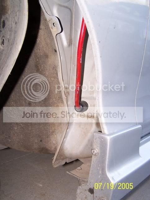

Old Jul 18, 2005 | 09:54 PM
firebug21's Avatar
Posts: 155
From: Las Vegas, NV
I was working on my car and decided to take a picture of where I ran my cable from the fender side. Here you can see the area where the gromet that you can access from inside the car. I saw another picture in another topic that showed the view from inside looking at the hole.
