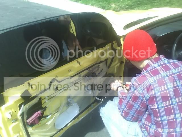

Once the door panel is popped off, it should look like this:
STEP 8:
Again use the screw driver to take out the 4 screws surrounding the speaker

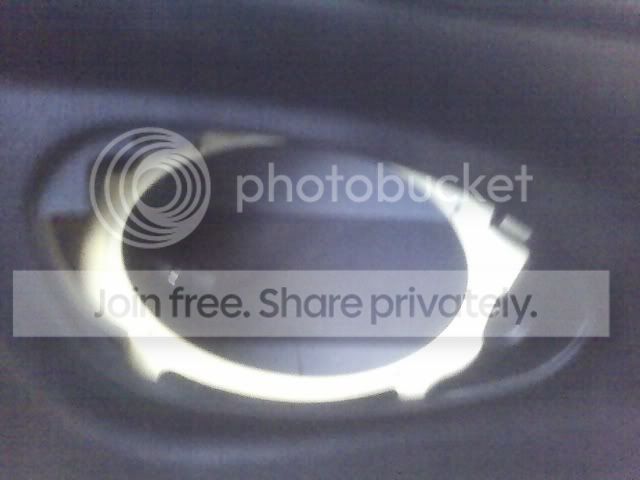

Remove the wires at the back of the speaker from where they are being held in
It should look like this without the speaker inside

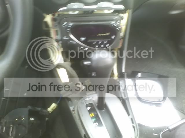

Pop out the console where the old stereo is
It will look like this after everything is taken out

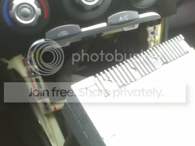

Gently remove the old stereo and unclip the wire connections from the back
This is what the back of the stereo looks like

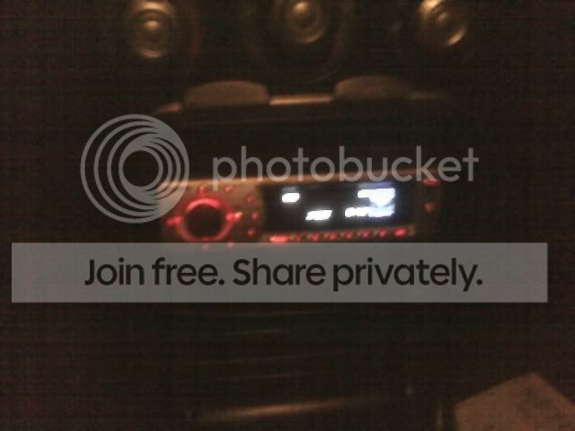

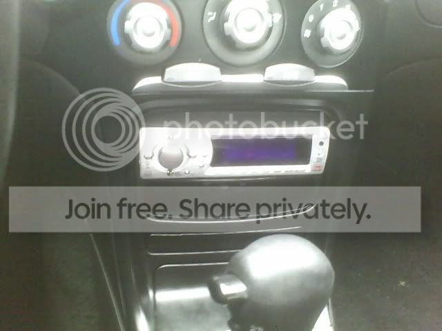

Start you car, and you now have just totally redone your sound system
This is a picture of my stereo after everything was put back together (taken at night)
This is the same stereo just taken during the day
