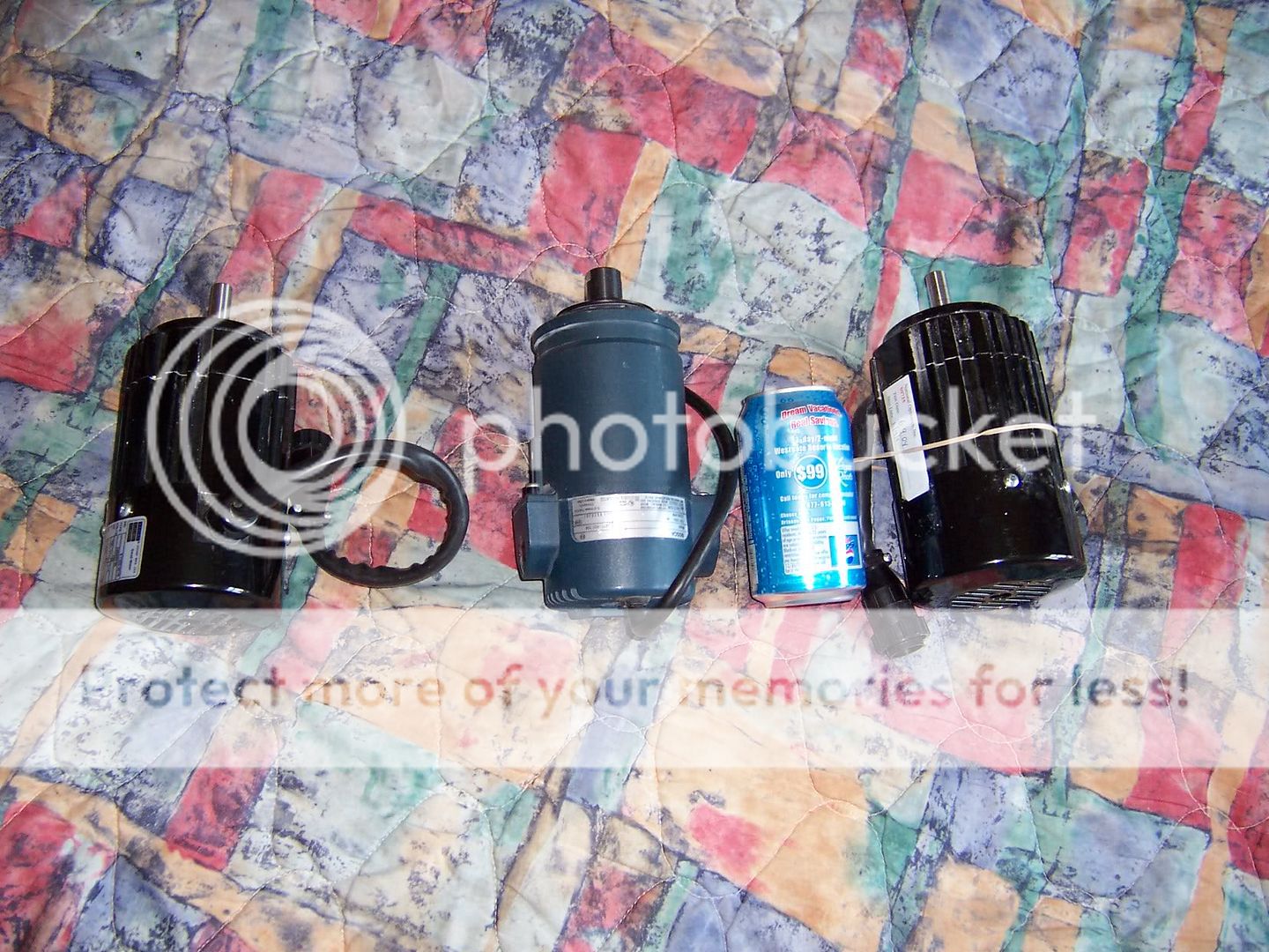

Hey mang, I've got some of those high powered motors I was talking about before.
I've got two 130V 5.7A 20,000RPM continuous duty cycle motors, and 1 115V 9A 25,000RPM. I gaurantee they will provide the power you need. I've got them just laying around now.

I don't think it's gonna work for you, the motor your using will spin 18,000 rpm with no load and maybe can output about 1/10 of a horsepower, the way you have it geared it will take alot more than that, in order to spin the compressor and actually compress air to any psi it will be under a major load and I bet that motor will overheat and burn the brushes out. Your best bet to get it working would be to mount it to your engine and use a pulley off the crank, your halfway there and it will work that way.
