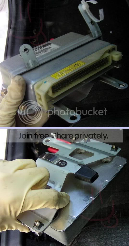

The ECU is here. It looks like this under the dash in my car. No, there is not enough room to get this thing in/out of there.
On the donor car with standard transmission, I got out even the brackets mounted on the ECU. For my car, I had to disassemble the bracket for the relay module, and reassemble it as a 3-piece puzzle, inside the dash. Boo. The final bolt was set with about a foot of extensions and a swivel, because my hand+wrench combination would NOT fit.

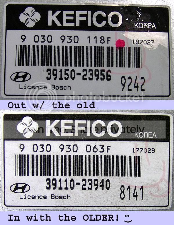

Labels...

I revise my assessment. After fixing my exhaust leak by replacing the exh. manifold, and doing some A-B-A-B testing.
The power boost is about the same as when you turn off the air conditioner: noticeable but not extreme. My engine runs a little rougher with the 1.8L ECU also, but it took going back/forth to notice it and it's not a big deal
