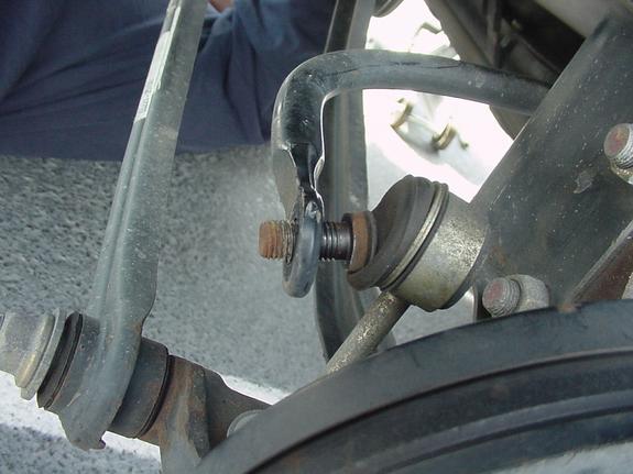

1. Remove rear wheels to gain easy access to mounting points of stock sway bar.

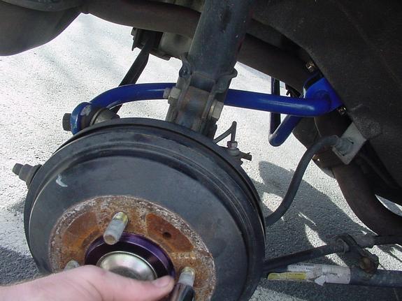

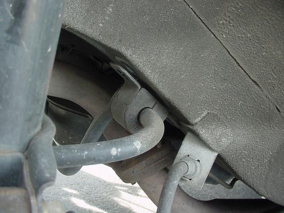

2. Remove Nut holding end of the sway bar using 17mm socket
3. Remove 2 12mm bolts holding mid mounts

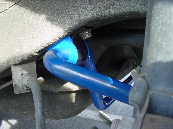

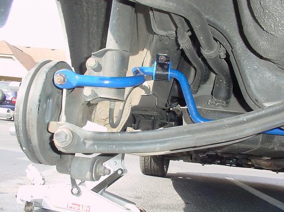

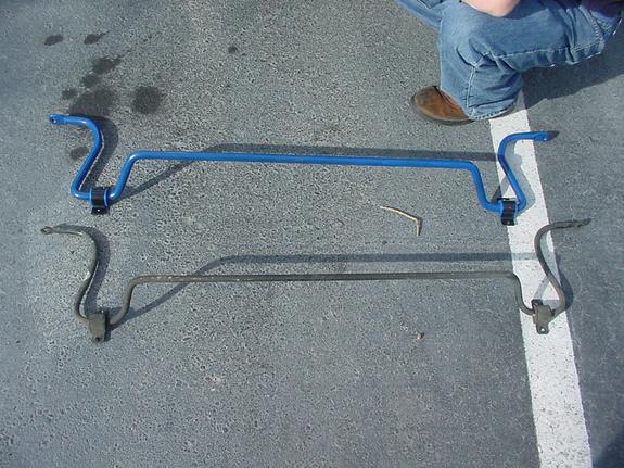

3. Throw away stock sway bar. This is a pic comparing stock and HVE sway bar side by side. You may not be able to tell much difference in the picture but HVE's sway bar is at least 2 times heavier then stock not to mention a lot thicker

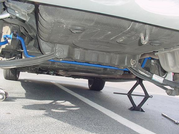

4.Bolt that new bar back under the car and you're done.
NOTE: you may need to bend new heavy duty mid mounts to get botl holes ligned up.
