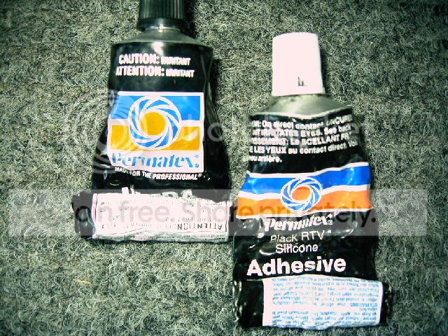

- Liquid gasket. It's like silicon.

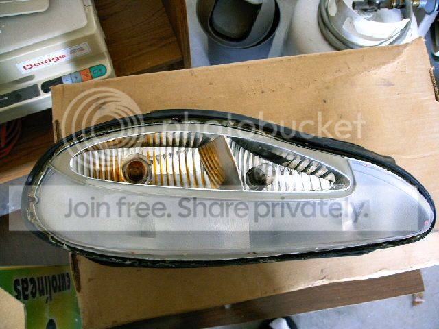

1.Start off by removing your tailamp. Then remove the bulbs and wiring harness and anything else you have there.

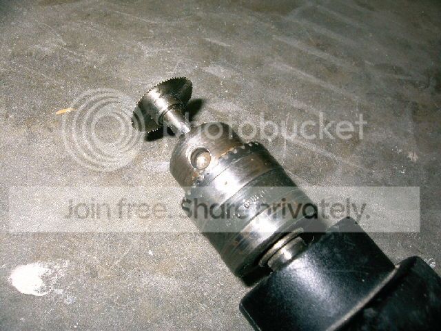

2.Get your dremel and start cutting around the edge of the lamp making sure you leave enough room so you do not cut any of the tailamp housing. Picture thanks to 2UNIQ
3. FOR STOCK TAILAMPS Once you removed the lense, place on a baking sheet place tailamps in the oven at 300F for 3 minutes, then remove and try to pry out the rest of the lenses thats left around the edges with pliers or screw driver.DO NOT PUT AFTERMARKET TAILAMPS IN THE OVEN. They will melt. Go to step4 if you have aftermarket lights.

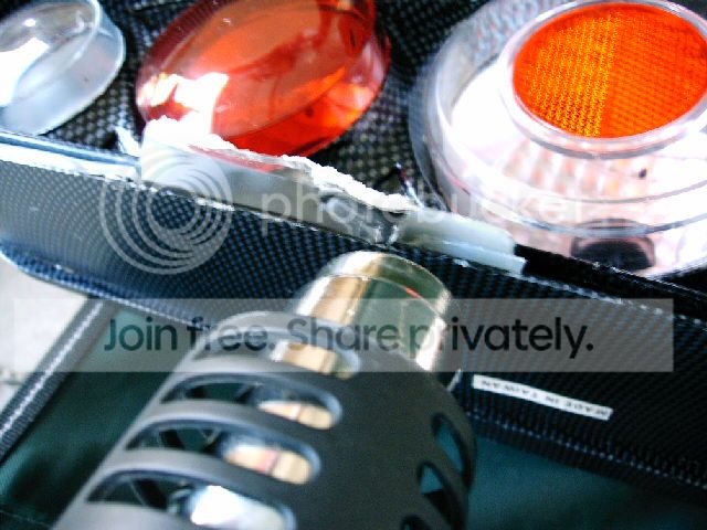

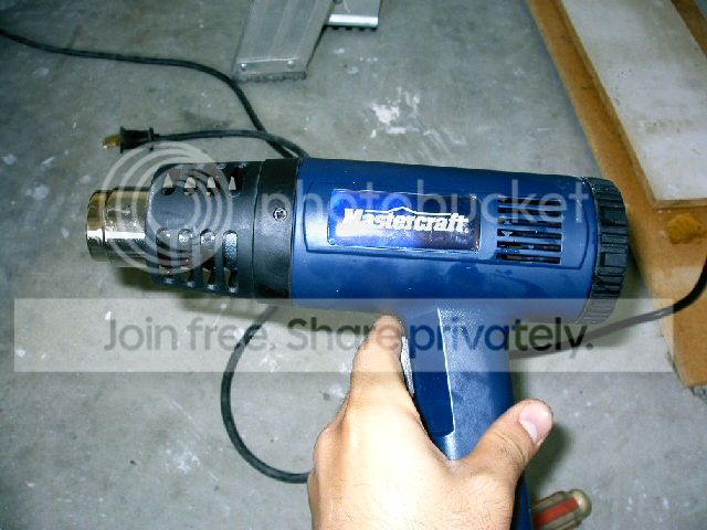

4. FOR AFTERMARKET TAILAMPS With a heat gun carefull heat the sides of the tailamps, small sections at a time making sure you do not melt anything. I would recommend low heat. Try to heat up the sealant instead of the actuall plastic lense. Aftermarket tails are hard to remove the lense from the sealant but it can be done with time and patience.

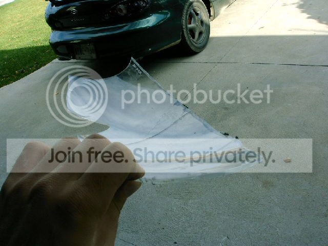

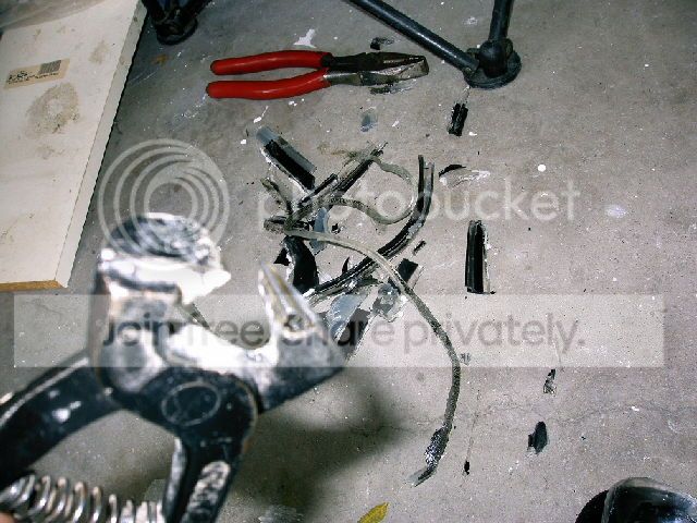

5. Use your pliers to pull up on the lense, or use a flathead to get under it and pull up. I used both techniques.

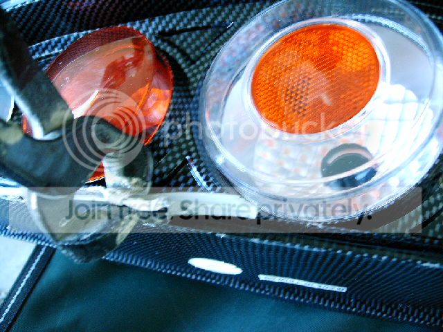

6. Once you removed all the remaining lenses it will look like this.

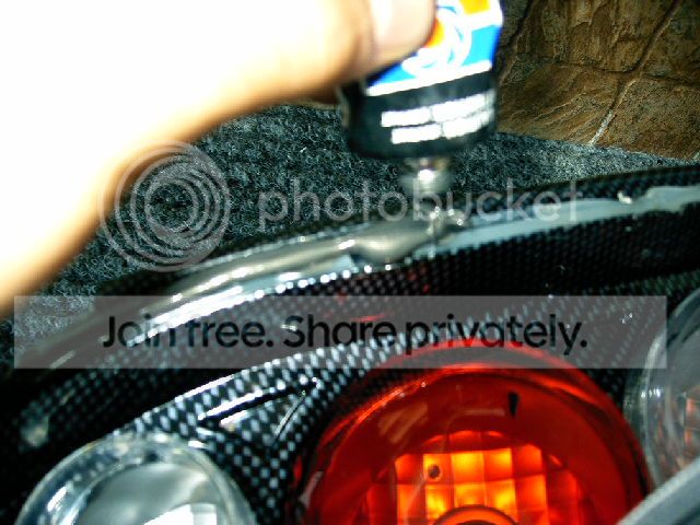

8. Once cleaned, take your sealant at put a thick bead all away around the tailamp over the old sealant. I wouldnt recommend removing the old sealant because it adds more protection and also lets you use less of your sealant. Moisture in your tailamp depends on this step and the next two so make sure to take your time and use lots of sealant.

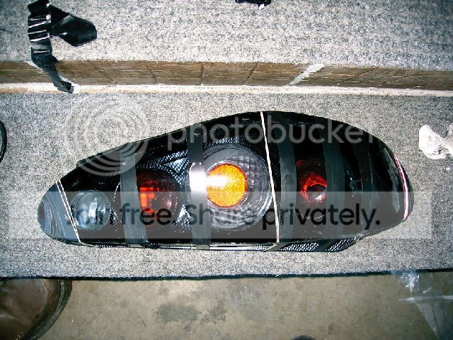

10. Once you have them on like you'd like, with somebody else holding the lamp flat with the lenses pointing up, start wrapping the lenses TIGHTLY as you can with electric tape. If you can't find anyone to help you, then you can use elastics before taping them to hold them in place. This option is a bit harder and you will get dirty with sealant.
11. Let the sealant dry. I would recommend waiting 20-24h before removing the tape.

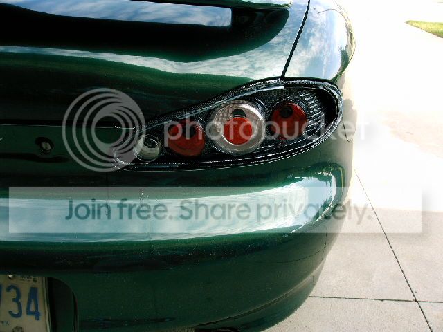

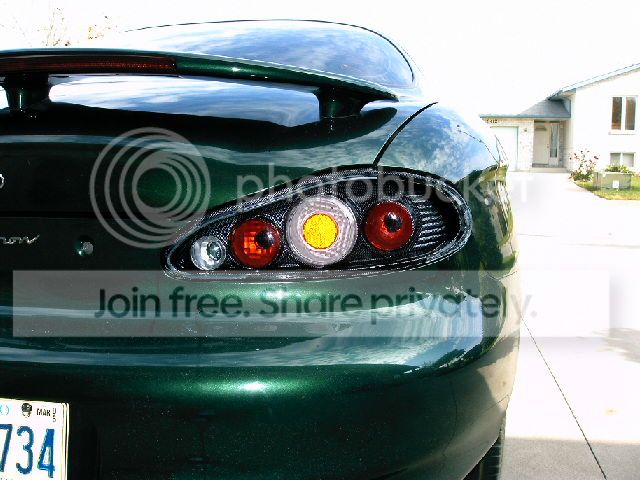

Pic thanks to 2UNIQ. This is with the plastic light dispenser inside the tailamp removed.

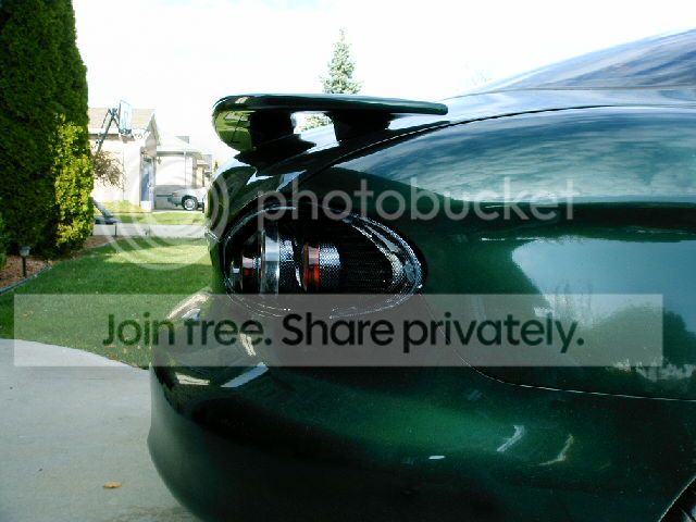

Heres them with tape:

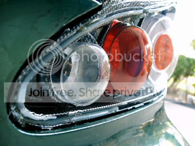

For the people that have thought on removing the lenses off aftermarket lights and leaving them like that you would have to cut the lenses off and leave the rim on the side like step 2. Once your finished that sand the lense rims so that it looks like thats how you bought it. If you decide you want to remove the whole lense its going to look like crap. Heres why.
You can see the groove from the old lenses and all so all the glue that is almost impossible to remove every bit off it unless your ruin your housing.
Heres what they look like with just the lenses removed for ^^^ those guys that want no lenses.
