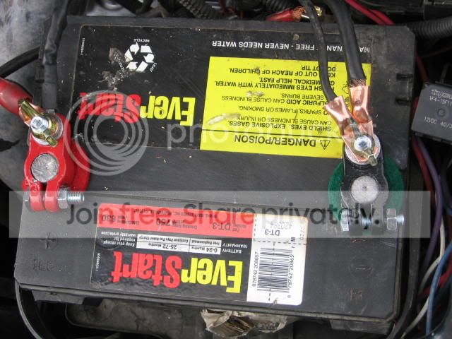

that is what my battery looked like notice the negative clamped down all the way

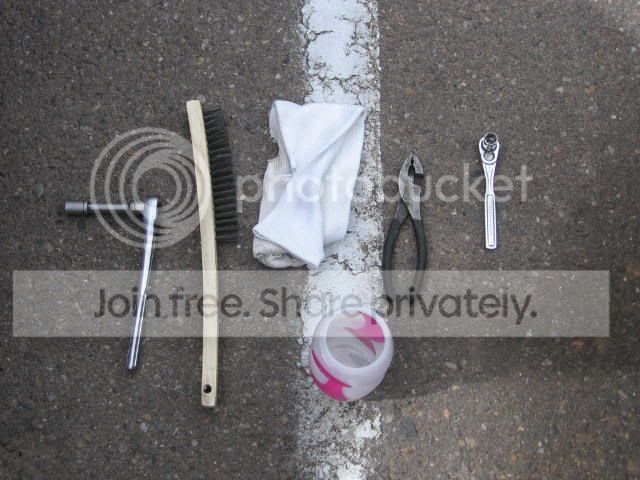

and these are the tools you will need
a wire brush, some water, a rag(holey socks work), pliers, a 12mm socket, and a 11mm socket (sockets depend on the size bolt on the terminals)

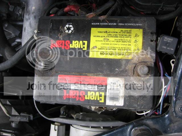

after removing the terminals this is what i saw
can you say corrosion? corrosion is bad it can leave you stranded, under power a amp, dim headlights, etc

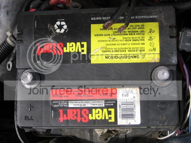

so poor a little water on the battery (dont worry it wont shock the hell out of you) then clean with the brush, afterwards use the rag to clean off the top of the battery- mine looked like this after

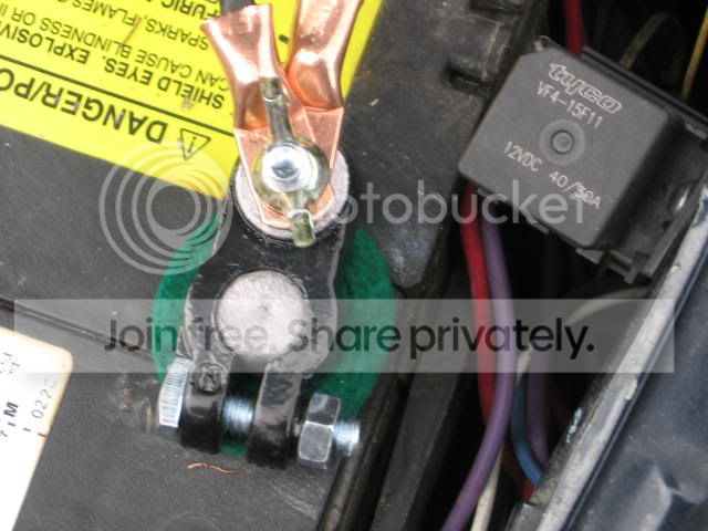

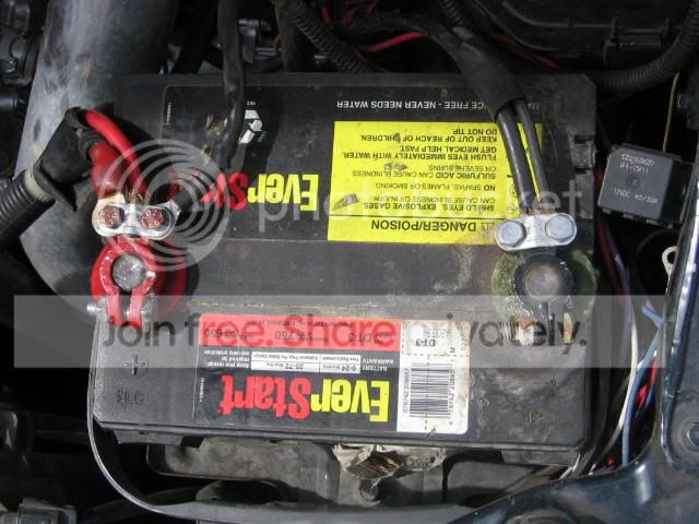

now put the protectors onto the battery then install terminals and tighten them with the 12mm socket after that clamp the connectors onto the wire (if your still using the stockers you will need to cut off the terminals and install the connectors) the wire for the starter already has a eyehole connector but it is too small to install onto the marine terminal so you might have to drill the hole bigger(what i did) or find another way to install it then install them all onto the marine terminals like so
when your all done it will look like this
now when i need to reset the comp i dont need ANY tools i just have to unscrew the wingnut and remove the wire

Great DIY, but I don't like how that ground looks..the wires are too exposed.
It does look nice though.
Old Jul 23, 2005 | 06:08 PM
yeah i gotta get some heatshrink for the ground wires
if you look at the positive there is some but i ran out lol
oh and the epoxy coated kind resist corrosion really good so no need for white grease just keep a eye on them and clean em once and a while
