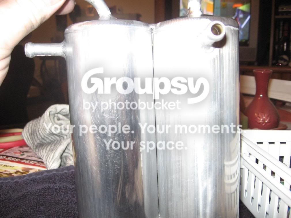

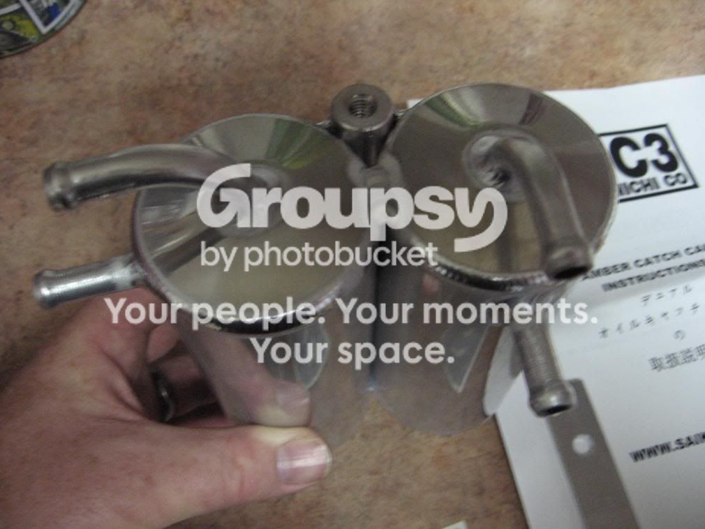

New Catch Can setup, before.

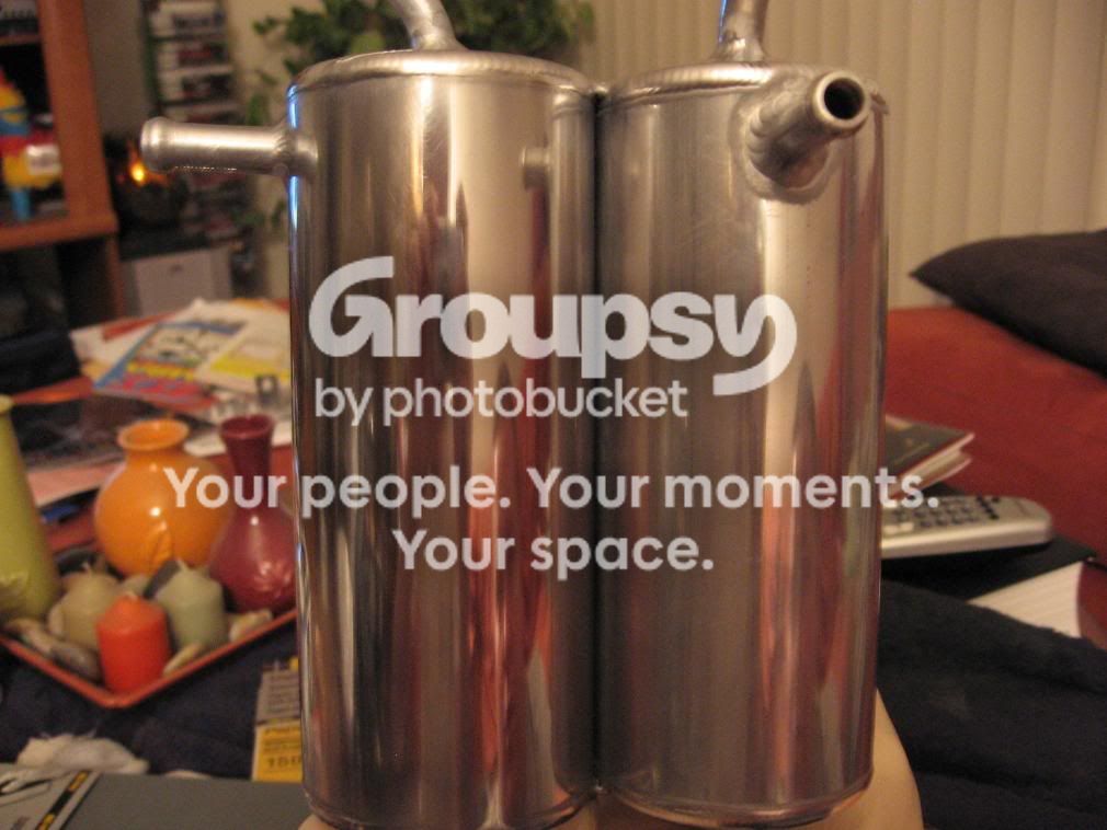

New Catch Can setup, during. Left side has been hit with rubbing compound, right side is still untouched.

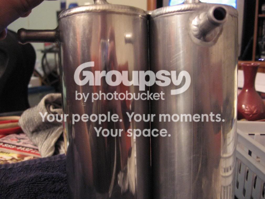

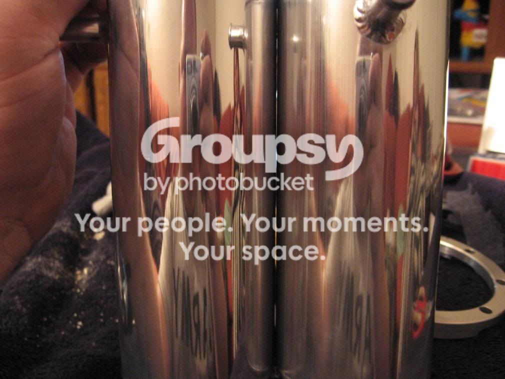

Same in these 2 pictures, more detail.

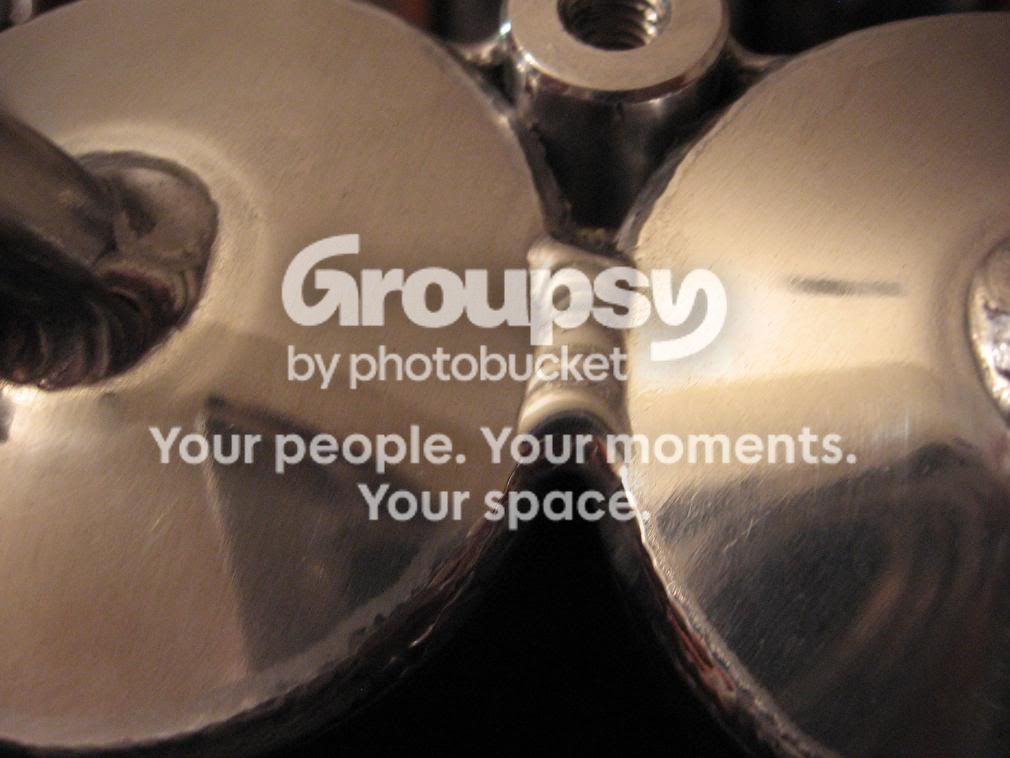

Before, note the welds.
Note the welds, all of the white from the aluminum welding is completely gone after a few minutes with a sock and some rubbing compound.

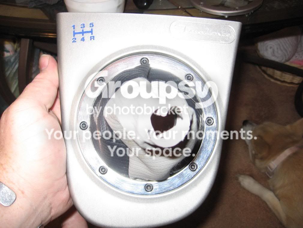

Shift ring complete.

the white oxidation on your welds Jer is commonly known as "sugar" . it's from the weld procedure (usually Tig welding) where the impurities leave this whitish film. just FYI, no biggie, but i know you like to know little tidbits like that.

Thanks for the info man, I was wondering what to call it.
Full writeup on this new catch can in a few days.
