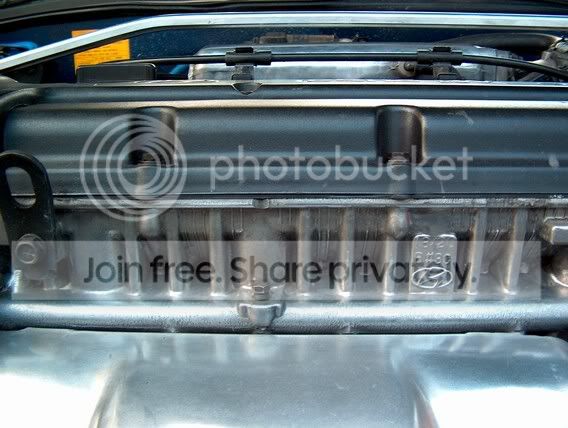

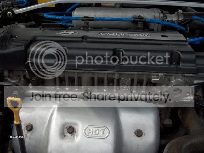

This is when I just cleaned it with wd40 and a rag, dont do this it barley cleans your engine and when I was driving to school after I did it the heat vents all the sudden shot smoke in because of the wd 40 residue
Step one: polish your engine with the mothers and rags, it will turn black then wipe it off
Step 2: use the 220 grit wet and dry to sand the IM and lip of the engine, above the heat shield. sand these down and where ever else is rough too if you really want those were the only 2 spots where I decided to do it
Step 3: to see how amazing the engine can look put the mothers on the one machined surface of the engine above the radator hose, then use a dremel with a polishing tip on it and polish it, I did it until I could see myself laugh.gif
Step 4: Be patient and polish the rest of the engine and IM with the dremel and mothers, wipe it off when it turns black, you'll get the hang of it its really easy
Step 5 use the purple power stuff to spray the areas in the engine where there is dirt built up, its a degreaser, DONT GET IT ON THE ENGINE, I was told because it suposeldy turns allumum black so dont spray the engine or the IM or any other stuff, I sprayed around te top of the struts, below the PS resovir and where the air box used to be, then to get it off I used a hose and didnt hit any wires or anything, but you can prolly use a wet rag
After B)
This was a 2 day thing for me because I had to work the first day and it was really hot but can prolly be done in one day if you are very patient

Looks VERY clean man good tip.

Thanks in the last pic thats a little mothers on the firewall I took the pic before I noticed that

I like your IM, have you thought about polishing it inside?

I am prolly gonna port it later this summer after the new garage gets approved form all the inspections

the dremel and polishing bit is a good idea. Did you use one bit for the entire job, cuz those can get pricey. thanks for the tips, I'll prob clean up my engine when I decide to get all the ricey engine dress up stuff (ya know, chroma and aluminum caps everywhere, and braided radiator hoses, huge 0 gage ground wires, the whole deal).
Your engine bay looks VERY clean btw. Get a shot of the entire engine bay (to get an overall view of the cleanliness)

I used two tips laugh.gif , you could maybe get away with one if you sand really well and make sure the tip dosent hit and rough surfaces because in someplaces it ripped the tip up where I couldnt see it
