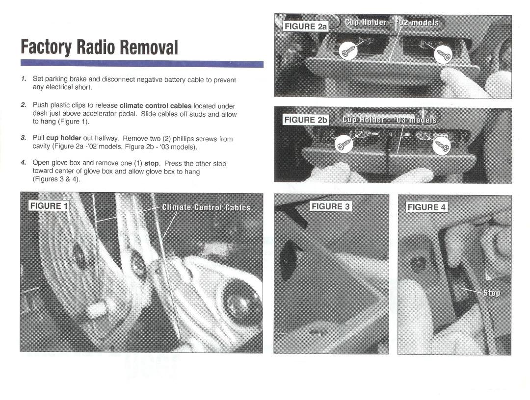

This guide is rather unclear. It only shows how to remove the glove box, but maybe the rest is easy.
To actually complete the process, is an Accent specific adapter harness necessary? The harness adapters I've seen have to be manually wired in to the OEM harness. Does anyone have the pinouts for the LC's audio wiring?
