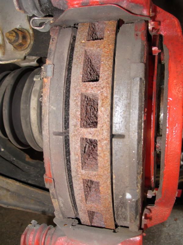

^Yes, but they extend the life of pads since there's less heat generated and more air cooling on the pad itself. Infact, this is often, but not always used in Formula 1 (depends on the driver and circuit for example always used in Monza because of the 200mph Rettifilio Tribune straight). In addition, aftermarket rotors have bigger slots on the inside than factory ones. I've been running Hawk pads on mine for 6.5 years now, and I use my brakes a lot! Call it a miracle, but this is the current condition of them:
You can still see the slanted edges, indicating low wear.
In general, there's less stopping power compared to when I had stock rotors, but given these results, I really don't care! You should be just fine with Hawk pads on stock rotors. My favorite pad is Axxis from Australia. Aftermarket rotor is just for those picky guys like me that want things to perform efficiently.
