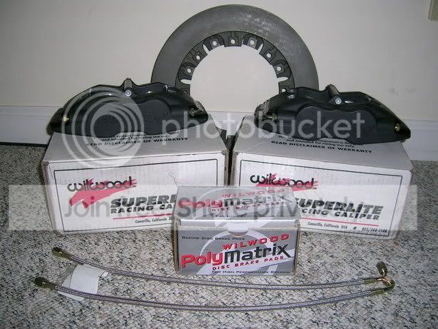

Now here is what I went with, and what I think for the amount of money I put into it, is absolutely PERFECT for our cars. Im going to put down how much I paid for the things too. Its going to be hard to find the same prices, particularly on the calipers and pads.
MAIN PARTS
1. Calipers = 120-7432 L/R (paid 75 for one, 86 for the other on ebay)
Forged billet superlite. they have 1.38" pistons and are for a .810 rotor. I initially wanted a caliper for a 1.10" thick rotor, and .81" is around(or maybe even less) than stock thickness, but I talked to a bunch of custom brake people (TCE and the like) and the general consensus was that .81 will be fine, even for autocrossing. Plus it keeps weight and cost down.

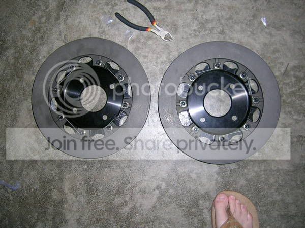

2. Rotors = WIL160-0471 straight vane, so no L/R (28.37 each, www.pitstopusa.com)
UL straight vane rotors. .81" width. 11.75" diameter. I have 16 inch wheels, don't plan on going bigger, and want the potential to run the stocker wheels during the winter. These suckers were cheap, and will work fine while I save to get the srp rotors.
3. Rotor hats = WIL-170-6996 (125 each from summitracing) they were the one thing I couldn't get a good price on)
GT series shallow offset rotor hats. They mate up almost perfectly,

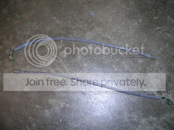

4. Brake lines = ALL48123 allstar -3AN to -3AN 18" (15.88 each www.pitstopusa.com)
Crazy cheap, good length seem very well built. I also coated them in a super durable heat shrink: HSPTFE4-050-FT from cableorganizer.com. if you go with the same thing get 6 feet continuous of the heat shrink, and use 3 ft on each brake line. When you are shrinking the stuff it is 4:1 ratio, so it shrinks down a bunch, but the length also goes down WAY faster than you would think.
5. Brake pads = 15E-6084K Polymatrix 7420E pads (35 for one set, ebay; 64.50 pitstopusa.com for the first)
I got two sets. E series seem to be the best for street sport applications. The best thing about the caliper is that there is like .63 inches of pad material, which is on the high side for wildwood brake pads.

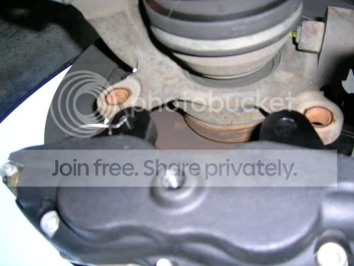

6. Caliper brackets = haven't bought yet
I was thinking of trying the caliper brackets made for the scion tc for the same calipers. The pt. # for that is 250-9012 from wildwood. Looking at other measurements I cant even remember tells me that the bracket will get VERY close to working, and at the very least will provide a base for slight modifications, all for 37.43 from the dealer I was going to go with(cant find on the net). It is definitely worth the money imo, even if it doesn't work.

7. Rotor bolt kit: attach rotor to rotor hat = WIL-230-6365 (16 each from summitracing, need 2)
Remember to safety wire them: http://www.wilwood.org/ds386.pdf

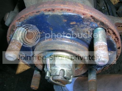

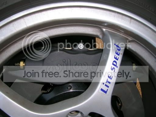

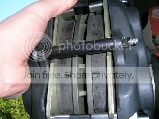

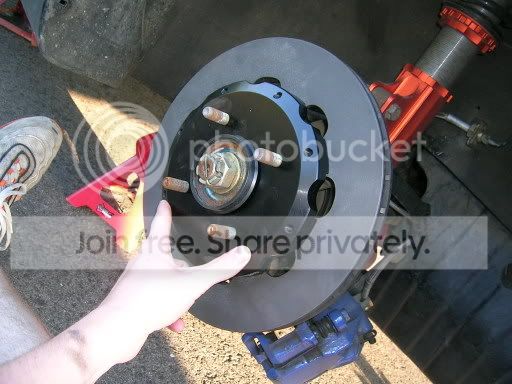

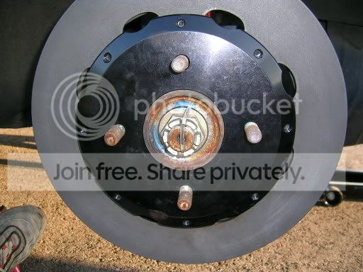

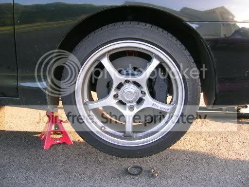

Pictures of my mock up:
pdf of sciontc kit
My link

So you figured out how to get the calipers to mount to the spindles then?
Old Mar 4, 2008 | 03:23 PM
just a bracket. havn't figured it out yet, but i could definitely machine something if the scion bracket i get doesnt work out.
you can see the general design of the bracket in the pdf file.
Old Mar 4, 2008 | 04:08 PM
if you can get me good dimensions for the bracket/adapter, i can draw it up in cad and have some brackets made for ya for very cheap.
all i would need it the distance between caliper holes, spindle holes and if they would be offset, and which way/distance they would be offset.
