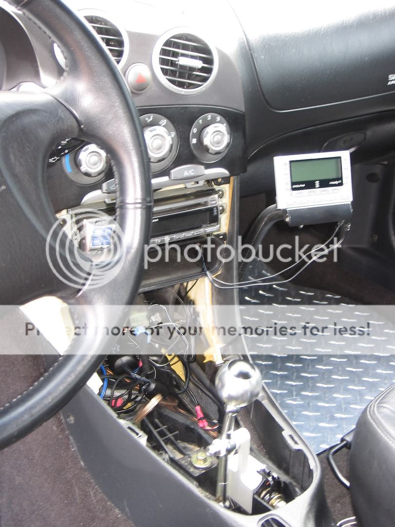

1. Pivot SSl-P Sequential Shift Light.
That's right, it's that small. Right on the top of the steering housing.
In the pocket under the stereo, on the left hand side, is the control unit. 4 buttons. That's it. There's 3 wires to hook up, Positive, Negative, and RPM signal. With this light, you do NOT have to hook up the RPM wire unless you install the underdrive pulleys. It can sense the RPM signal through the electrical system. Pretty neat eh?
You set it like this.
Hold down the left button for 5 seconds, the first light (left) will begin to blink. Rev the car to the first warning point (The RPM you want the first light to light up at), then press the button once again.
Repeat this for the second button from the left.
Repeat this for the third button for the last shift point.
That's it. From then on, when you rev up, the first light goes on at it's set point, second at it's set point, and at the third, all 3 lights come on and blink until the RPM's drop below it again.
The fourth button is to set the brightness of the lights.

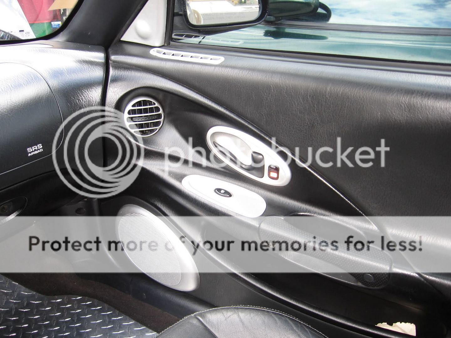

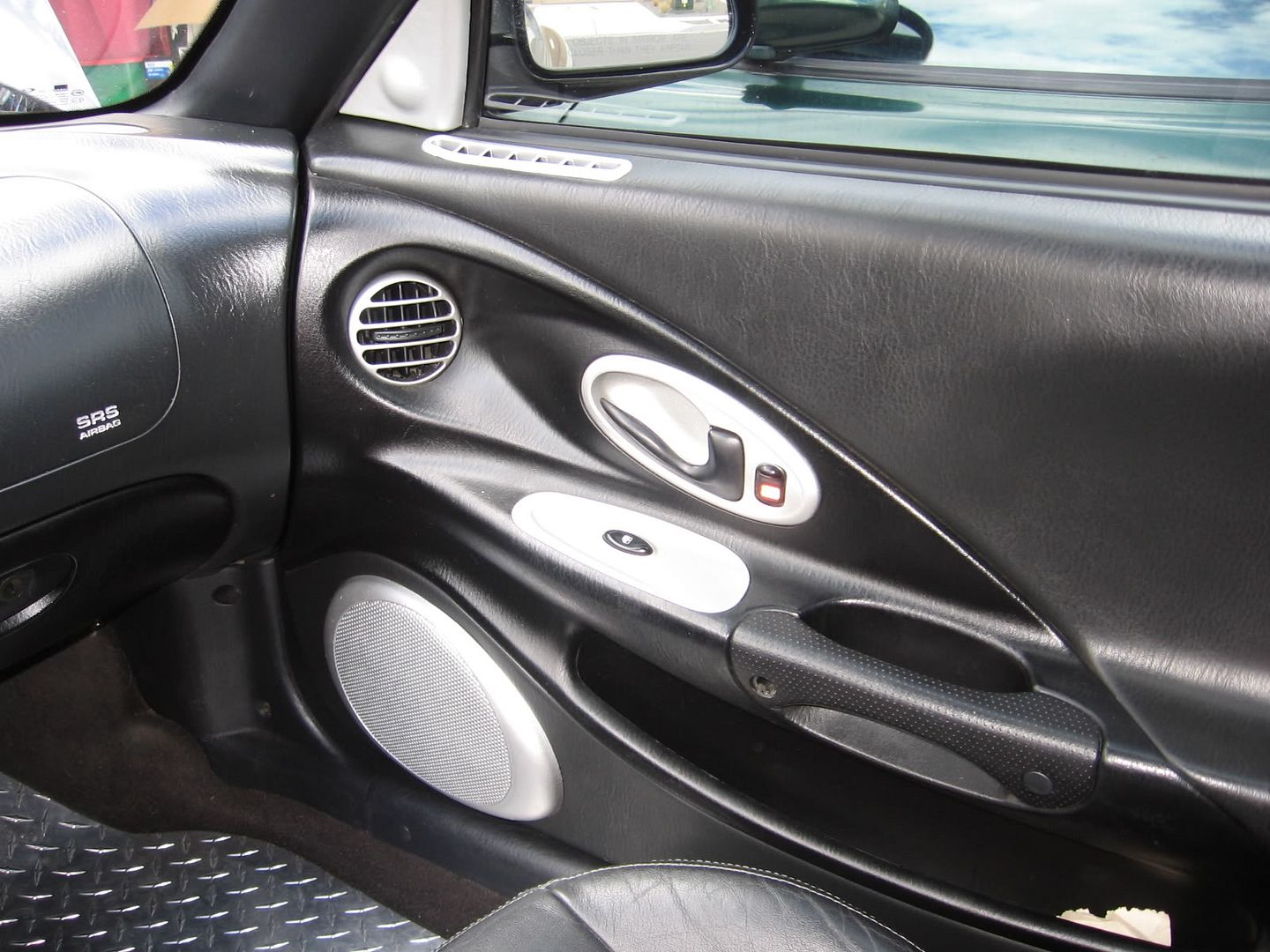

3. Painted the passenger door parts to match the drivers door.
Note the air vents. The moving one is a bit of a PITA to do, but comes out great.

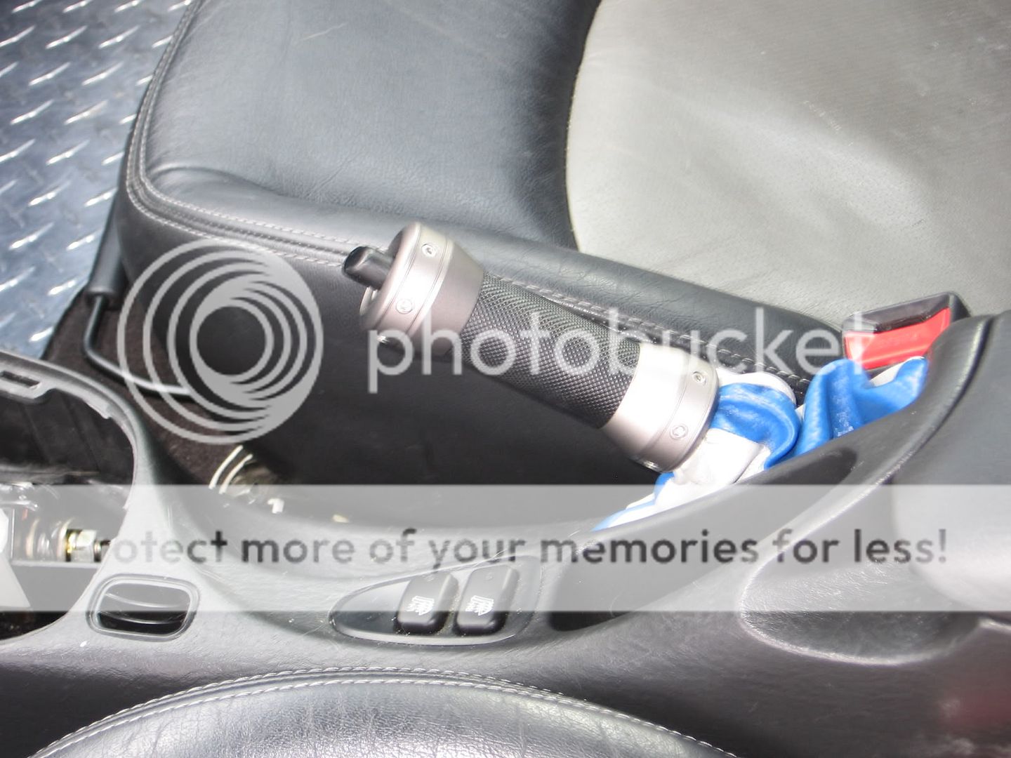

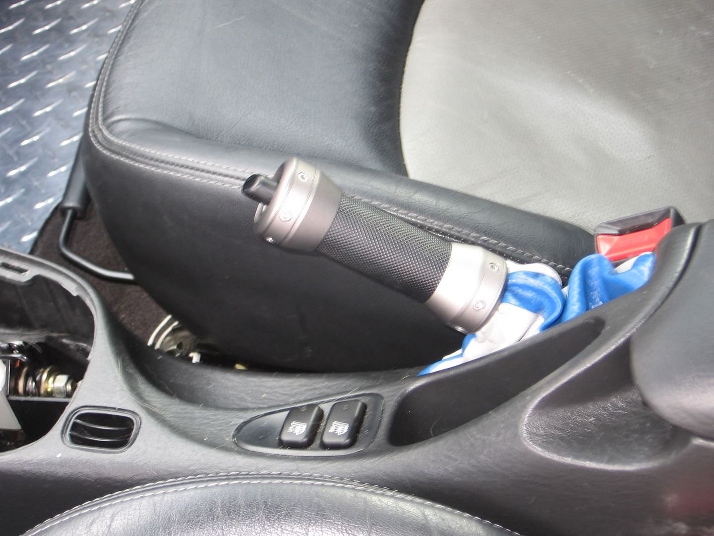

4. Custom Ebrake Handle
This was one of those things I just wanted to see if it would work, and what do you know, it did!
Pretty easy to do, get a GK Tiburon ebrake cover (Rubber), and trim it off at the first 3rd ring back from the front. Get a sharp knife and grind out the rubber stopper blocks on the inside. Get a set of Tuscani Ebrake Rings from Kspec or elsewhere, and mount them. Smack it on with your palm or a rubber mallet. Done. I'm swapping out the rings shortly with the silver set to match the knob.
5. New XM Reciever, Roady XT
Really nice, my favorite one so far. Supports stock ticker, sports ticker, artist/song alert, and 7 color screen.
