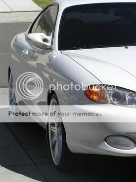

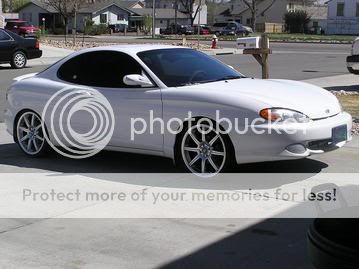

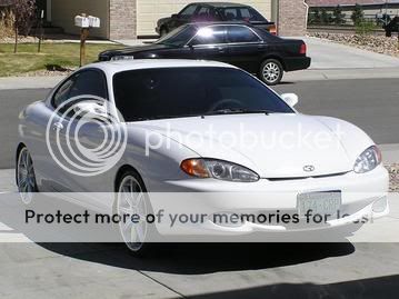

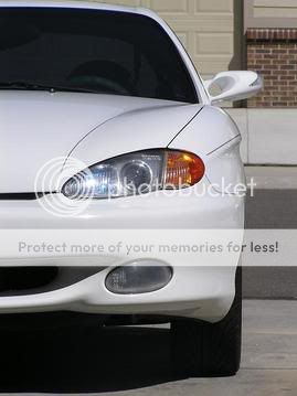

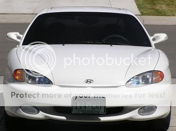

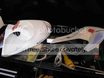

Well, after seeing Patreezy's mirrors at NOPI, I decided to get me a new set of mirros. These are the G2 M3 mirrors. Now, I think they look pretty damn sweet, BUT, they had fitment issues AND electrical issues. Like the very smart person that I am, I decided to spend the money and time painting them before I test fit and tested the electrical stuff. Luckily, I did manage to get everything working.
The blinker lights come with yellow and Blue lights, but I am just using the yellows. They are meant to be side marker lights and the blues are meant for blinkers. The yellow LED's are not very bright so I opened them up and added some tin-foil and also etched the outside of the LED. this made them about 2.5 times brighter and very suitable to be used as turn signal lights. I also had to resolder some of the connections for the LED's because they were loose. Oh yeah, did I mention all the directions where in Chinese!!!!
The next thing that kind of sucks in that the wiring, no matter how you do it, will be reversed in some way from the direction that your powermirror switch says. The best I could get was up/down being correctly oriented with the switch but L/R is not. Oh well, not a huge deal, but still annoying.
The mirrors are TINY compared to OEM. So, I also had to get two blindspot round mirrors to help aid in seeing. Again, not a complete downfall, but not the greatest.
So, in conclusion, I LOVE the look and the added safety of the side blinkers. I do not like how the item had no instructions, the wiring was impossible, and how the mirrors are so tiny that I had to buy round mirrors to compensate for there lack of quality. It's definately a strange feeling. I spent so long painting and getting them in, that its a let down to have the small problems eat at me. I suppose I am 50/50. 50% happy with the install, 50% disappointed in the lack of quality.
