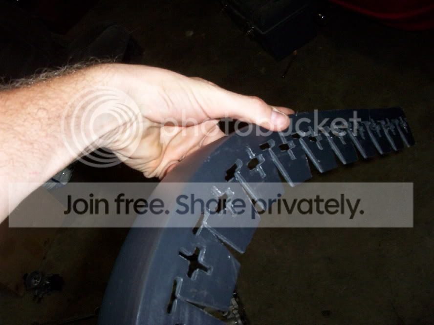

ok, i thought i did, so i checked, and indeed i still had a few pieces left from when i did my project.
the stuff he used is to flexible, so it leaves a wavey look to it. (it designed to flex to create a good seal) not really the best to use. i was hunting for the right product for awhile.

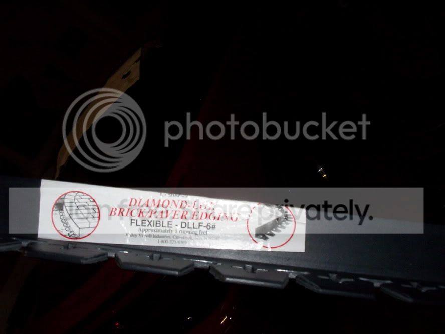

heres pics of what i used.
a pic of the sticker so you know exactly what it was.
here you can see that even though its heavy, and the end is not being held up, its still quite smooth. this stuff stays like this, and can take a hit against a sidewalk without issues.

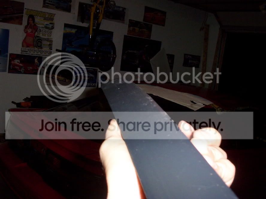

now heres the money shot, u can see why i LOVED this stuff for doing my front lip, its totally bendable around corners, and bends clean.
it mounts easy as hell with any kind of screw u want. doesnt warp, and is like 5 bux for 6 feet of it. plus the material is about an 1/4 inch thick, so its very durable, and probably stronger then most aftermarket lips out there.
im not hating on rd1tib, just showing theres alot better material to do this with.

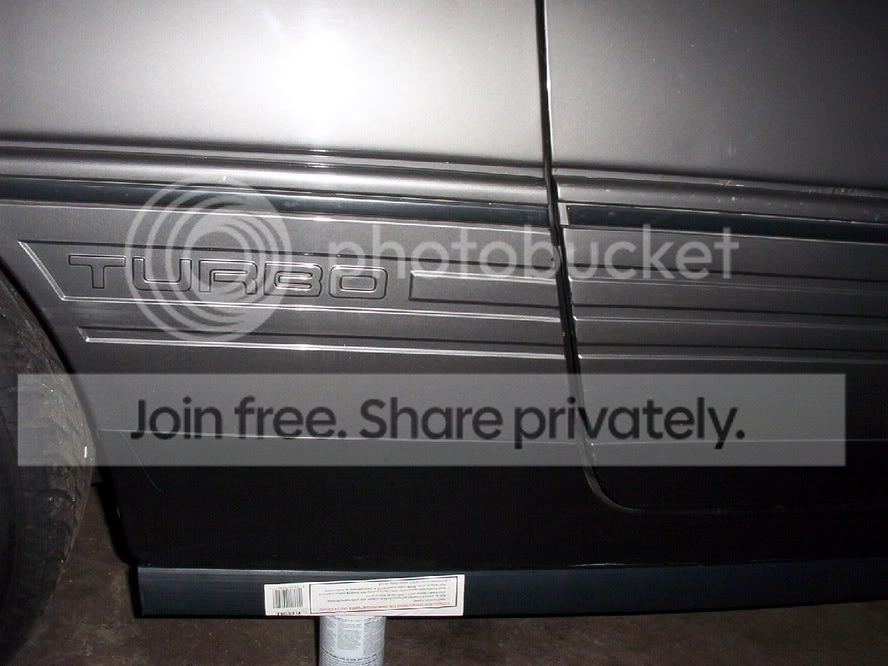

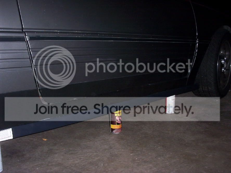

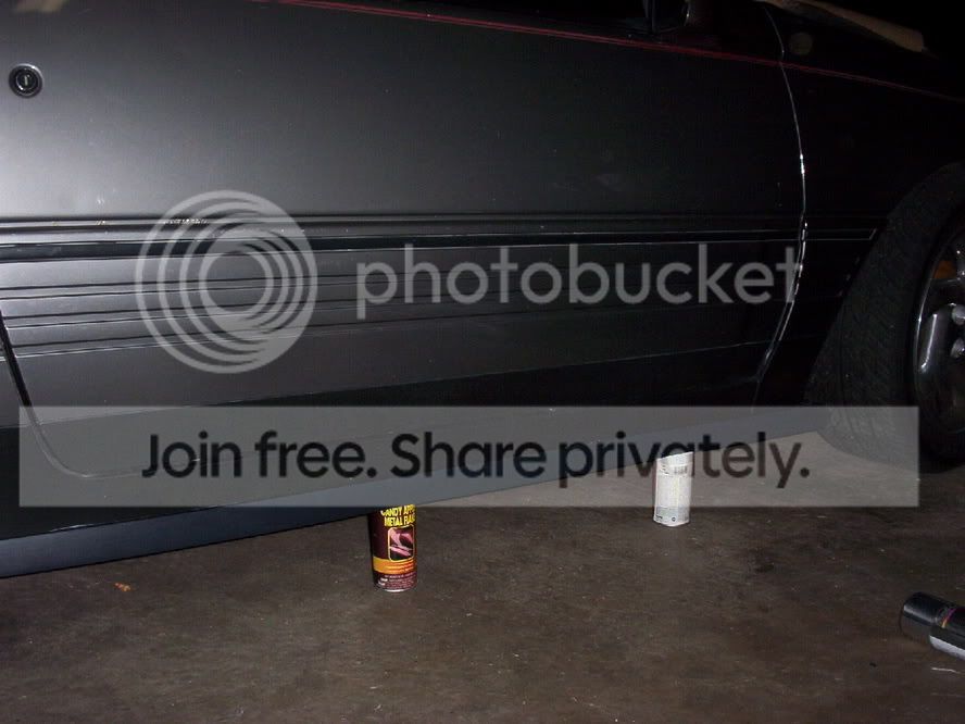

ok, just took a few quick pics. i used spray paint cans to hold it up so dont laugh. if they were actually screwed in they would look alot better because of the spacing i did with the cans being so far apart.
Old Aug 31, 2006 | 08:22 PM
^ I reckon the skirts look even better with the paint tins. You should screw them in too for a very unique look... that I'm sure nobody else would have fing02.gif
