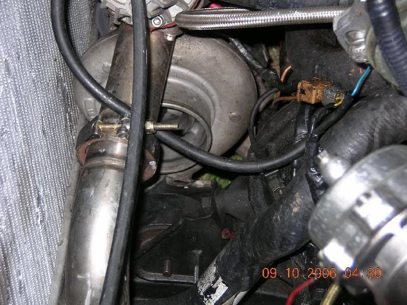

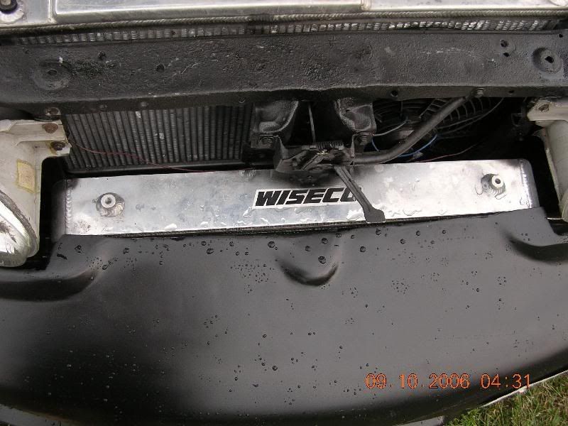

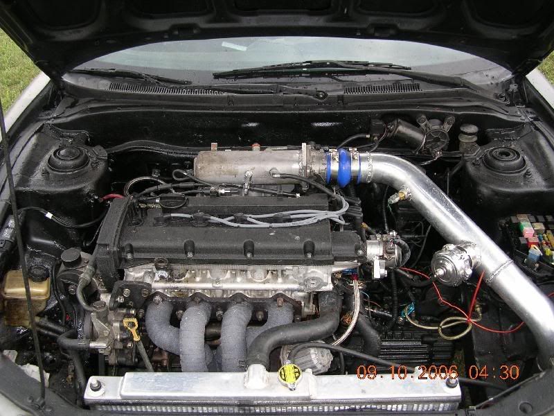

Well finished up most of the car over the weekend, Got it in paint well kinda, but I like it :OP looks stelthy. Anyway for those of you who dont know what I have done to my car here is a list and some pics of it.
weisco pistons
Coustom built rods (by me)
Ported head Knife edged intake ports
Cam gears
Act 2900lb mitsu clutch
Dsm CAS (for standalone)
70mm Throttle body
Holset Hy35 turbo
Hks 50mm wastegate 18lb spring
Tial blow off valve
Coustom turbo manifold (by me) wraped with dei wrap
2nd too 1st gen molded Veilside body kit with Ath rear lip
Autometer gauges Boost and pyro, oil pressure is cheepo for now
E-01 boost controler
Megasquirt standalone
42lb hr injectors primary 36lb hr secondarys for a total of 78lb hr
Areomotive 700hp efi pump and regulator with stainless lines
24x12x3 core bar and plate Intercooler 3" inlets and outlet
3" intercooler piping
3" mandrel downpipe back no cat
Hks dragger muffler
Innovate Lc-1 wideband controler
T bolt clamps for IC pipe and hoses
Evo 8 aluminum radiator (thats why there is no top brackets)
6.5 quart stainless oil pan (coustom built by me)
Head studs
17" bronz gt rims with 245 55 17 (?) yokohama parada rubber
Traction control bars (built by me)
Kaaz lsd
Thats about it for the motor end the rest is just visual and asthetic. here are the pics took long enough to get here are the pics.

exactly how did u make your own rods?
Old Sep 10, 2006 | 06:45 PM
t4turbotiburon's Avatar
Joined: May 2005
Posts: 191
See that building in the back of the 1st picture. That is where I work a machine shop. I live about 50 yards away. Building items like my rods or other parts for industrial applications is what I do for a living. Building rods is not difficult just labor intensive as the material is special very tough and hard to machine 4340 heat treated to 36-38 rockwell not hard but very tough. I can build my own rods far cheeper than crower or pauter could build me a set. Also I over built them i wouldnt be supprised to see them do over 1k hp I would think the pistons would go first.
