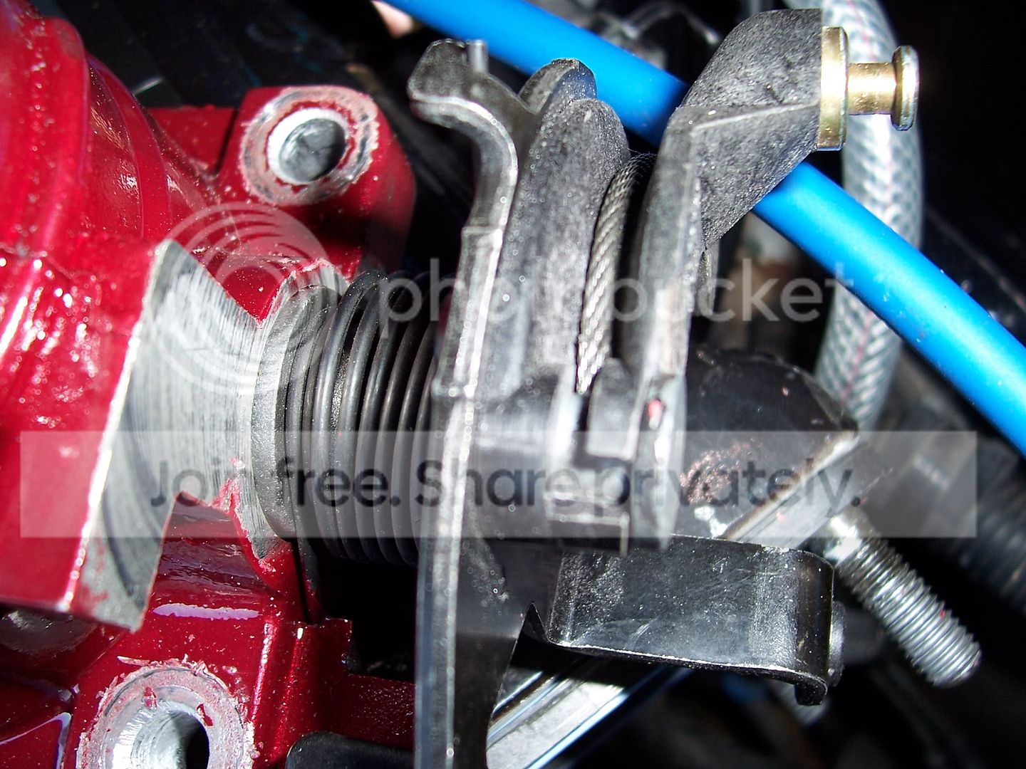

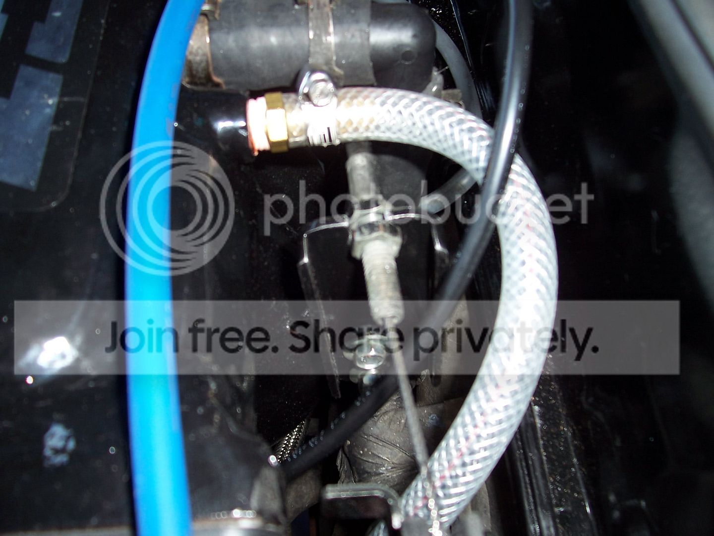

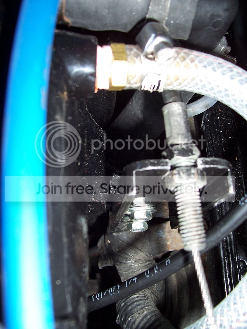

And heres the new throttle cable plate
And heres the on the tb. Notice where the button on the throttle cable goes in. This goes on top. Stock goes under. Also, you can see the little peice I had to grind a little bit, plus you also have to drill the whole in 3mm. You can't see it in that pick because the button is in there.

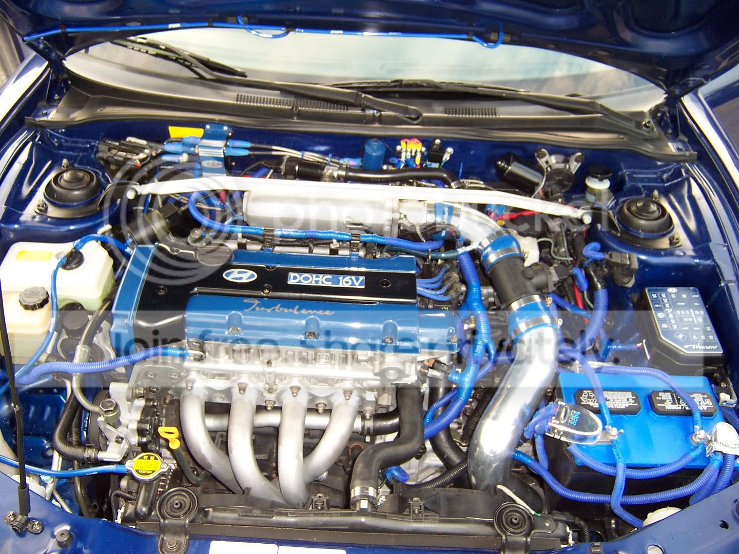

I've never seen one like that before. Usually when people install a strut bar they turn them 180, yours looks like it was turned 90 degrees... This is a pic of mine. You can see it pretty well. I chopped my mount just like yours is to remove the ugly strut bolt hole, but you have a different mount installed on the mount.

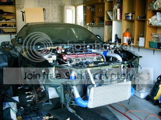

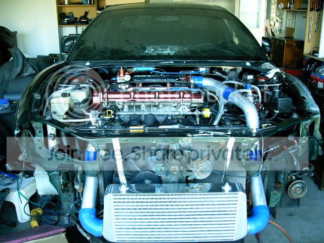

Old Aug 14, 2007 | 04:22 PM

very interesting. did you have to cut to get the charge pipes through there that way??
also what size fan do you have on the front of the radiator 12"?? and can you fit two of them up there? I need to take those measurements but have been putting off removing the front bumper.
Old Aug 14, 2007 | 04:36 PM
  #19
tanc's Avatar
Posts: 5,754
Thanks HKC
Supercow, Yes, you need to cut a bit to get the charge pipes through there but I didn't want to route them under or around, this is the simplest route for me.
The fan I have there is the AC fan. So which ever size that is. You can fit 2 of them there but you need to cut up the frame around the fan in order to fit 2.
Right now I want to see how one works, than I'll see about adding another one in.
