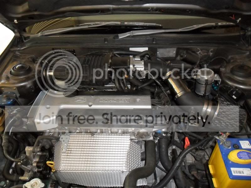

To increase my boost i need to decrease the s/c pulley or increase the crank pulley , with my current setup i don't have much i can take off the s/c pulley as its about 2.9" and the gap left between the belts from the tensioner set up isn't much either so my thoughts are on increasing the crank pulley so rather than getting a custom cnc pulley is it possible to use one from a different model ? my current set up is a eaton m45 on a 1999 2.0l elantra, i think the crank pulley is 5-15/16" x 1-3/4 from what I've read so maybe a 6" ?

I only got 6 psi atm running 305cc injectors and a walbro 255l fuel pump, i'll settle for 8 psi until i do some more engine work . I've got a tigerlily 65mm throttle body going on soon.
So my thought of using a crank pulley from a vehicle that has a larger diameter than the elantra was not to use the oem but a lightweight/underdrive so the inner would then therefore be the same diameter as the oem elantra but the outer would be greater ?
Does any one know what the different hyundai model crank diameters are?

Some good news some bad news - From the dyno the new 57mm pulley got me 9.5 psi and 240 hp @ the flywheel with the bigger 65mm throttle body, thats the good news the bad news my current engine wont support the extra as such. Basically got too much boost to use as hp , timing had to be retarded to stop the pinging [detonation] so i need to make a few changes when i get a rebuild done to get the waiting hp.
But it sounded awesome on the dyno and a few surprised heads turned

Original stock engine atm
Auto tranny
BKR6ES-11 plugs
4-2-1 extractors 2 1/2" to FG XR6 cat [local aussie ford v6 cat] back to standard system via straight through sports exhaust[made in u.s.a by thrush]
Haltech Platinum 500 ecu
65mm tiger lily throttle body
Pod filter
crank via A/C pulley
I do have a crude water injection kit in the shed i could play with, as this project wasn't about building a monster and being an auto I'll probably use what I've got but when i do an engine rebuild i might try some options like either a thicker head gasket or go with the 1.8l pistons and rods to lower compression.
