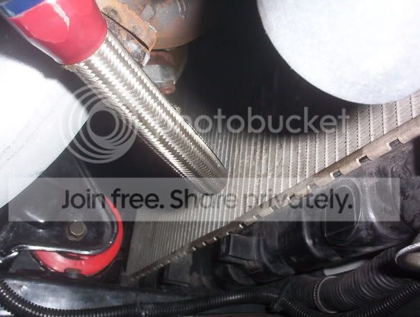

Now I Have the return spot in the pan the same way for the past 2 yrs on m other setup and never had a problem. But with this seteup the turbo sits lower and return line had to be shorten and it there was no way to makea Direct straight down dump it had to come in on a slop like Mad-Jons setup.
And from what I can remember correctly ,,,again this was 2yrs ago when the pan was off for the bung to go in this was the heighest this could go up from the inside....then again it was 2 yrs ago
Here is the way my oil return line comes in..Not the greatest I know...but what am I suspose to do?

Ouch that is a little rough. It seems like the oil may just stay in the return line as there is nothing but gravity sending it back to the pan.
I suggest maybe a little bit larger return line, and making sure that it goes directly to the pan. Looks like there is a little bit of a droop, or up-turn in the line. 02.gif
My only other suggestion is to spend too much money on a oil cooler/pump assembly. Pain in the @$$ mind you but temps would not be an issue.
I agree it looks like the drain. I had the same problem it was angled weird and resulted with some oil in the compressor the seals are probably okay if it was for only for a short period of time. The turbo will probably still be okay as long as you correct the problem the seals will just we worn a little.
