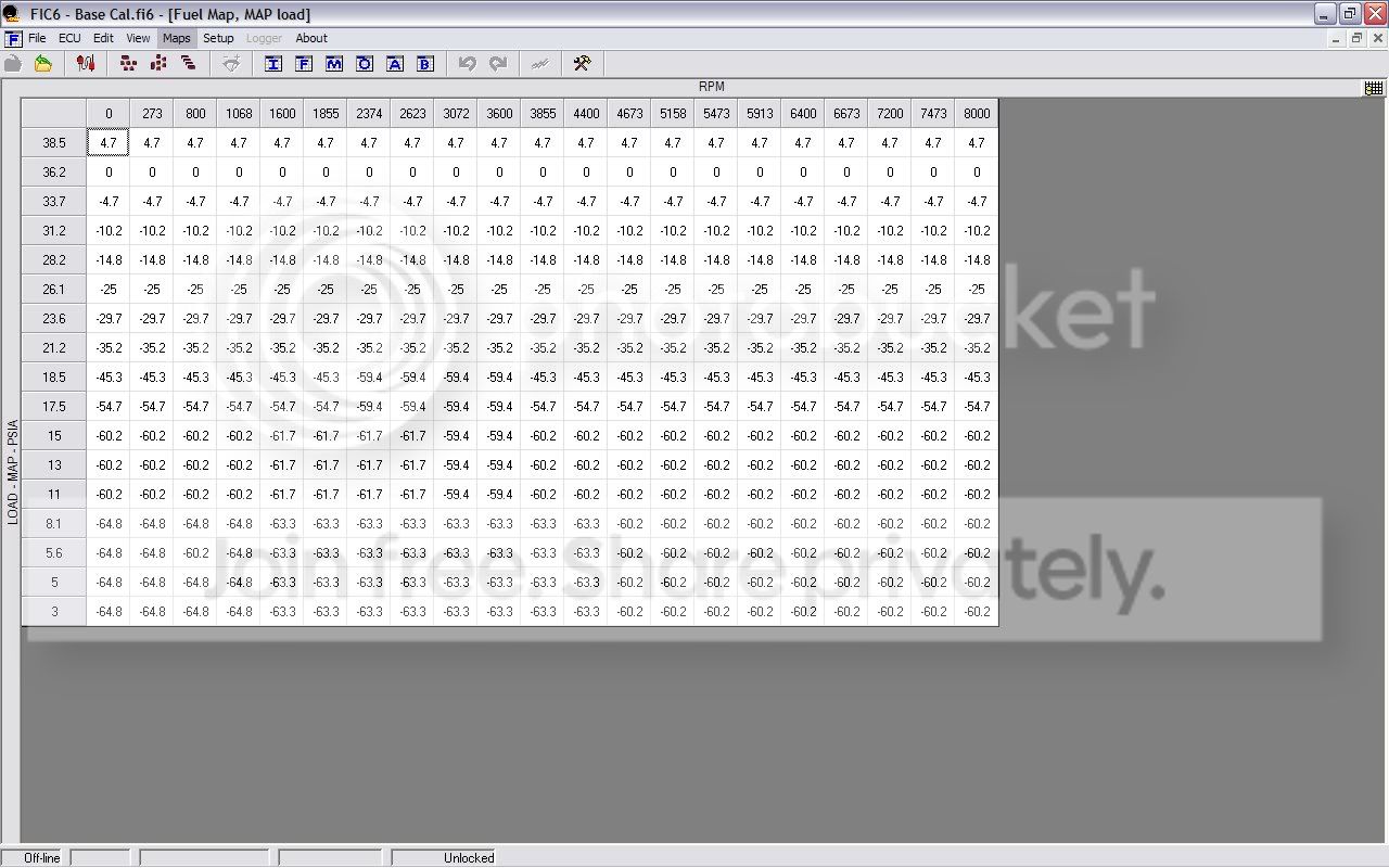

Here is my Fuel map:

did you do the injector scaling, or just adjust the fuel map based on the ratio of bigger/smaller injectors?

try doing the injector scaling, where it does it automatically: before inj. 210cc = after inj. 650cc and itll automatically scale it.
at least try it once and see how it compares to the fuel map you created.

I did use injector scaling that was the first step before adjusting the fuel map to meet demands.

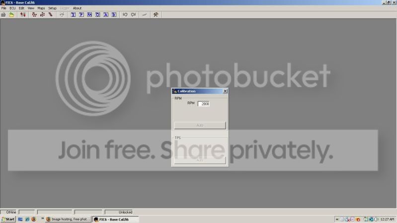

is there a TPS setting on the FIC that you have to calibrate?
if so, i had almost the same issue it sounds like your having with it showing LEAN on the wideband and terrible bogging, it was because my emanage wasn't recognizing the TPS. i calibrated it with the emanage, and voila, fixed. not sure if its the same issue, but its possible.
