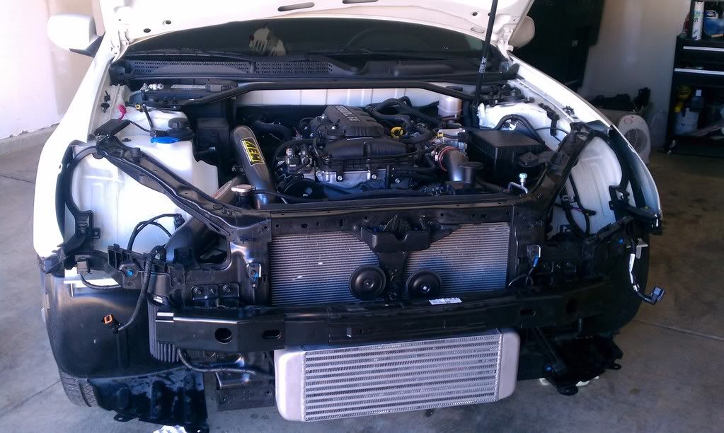

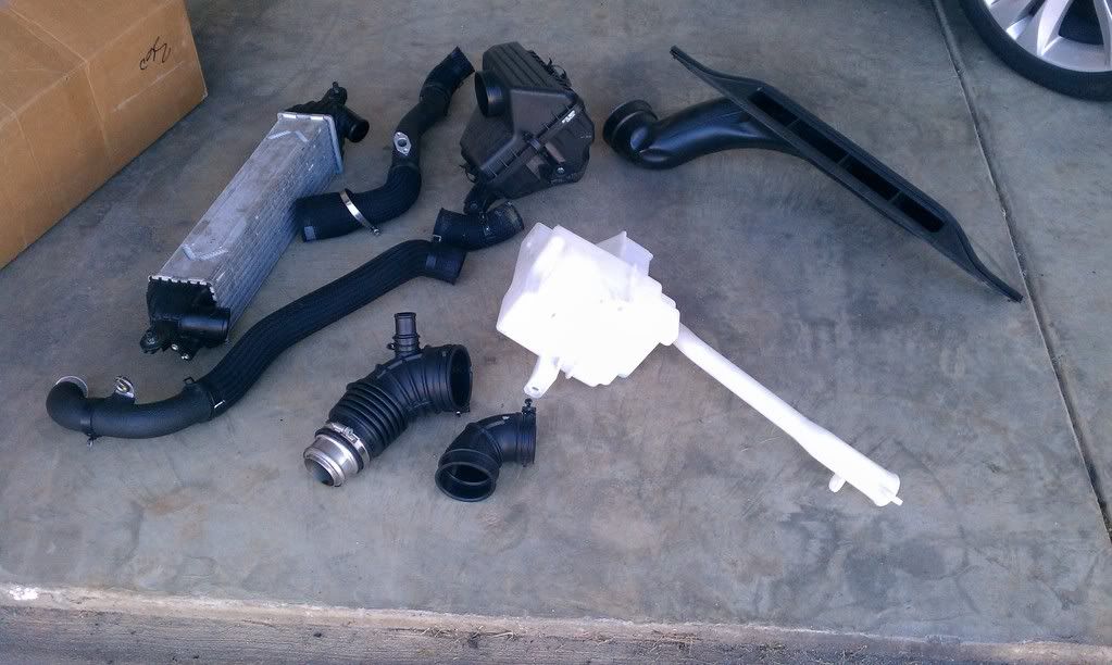

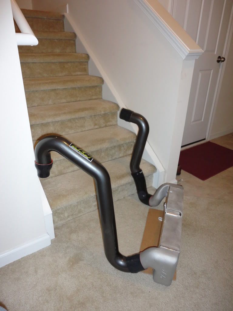

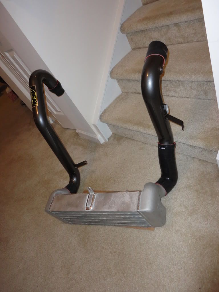

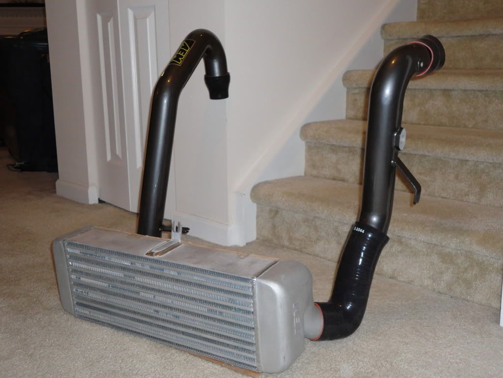

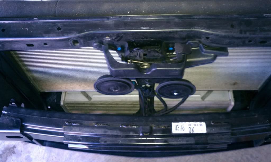

I spent the last few days putting together my AEM CAI and FMIC. Here are the pics... enjoy! :biggrin:
First... the before and after.

Looks like a nice kit, its great to see more Hyundai support from the well known companies. How much did it set you back and how long was the install?
Old Jan 30, 2011 | 04:49 PM

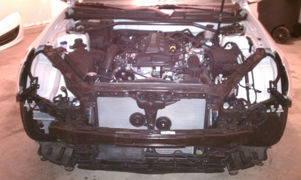

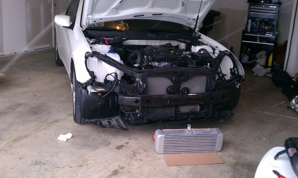

I did it by myself, a few hours at night after a long day of work. I took my time to make sure everything was PERFECT. Total time, about 15 hours. That included struggling with the fan housing for an hour. If I had help, probably would've been 4-6 hours. Now that I know the car and I'm familiar with the engine bay, I could probably do it now in 2 hours, with someone helping.
AEM CAI + replacement washer fluid reservoir and AEM intercooler and charge pipes... just over $900 shipped.
This yields approx. 12-15hp on the dyno, but I get more response and a better driving feel. It also has more response in 5th gear at high speeds.
This is the starting phase. The next round will be a downpipe with a high flow cat, test pipe to delete the 2nd cat, and a tune. Hoping that'll be about $950. Having these pipes in place when that's installed will hopefully meld everything together. At that point I'll be hoping for an increase of ~50hp.

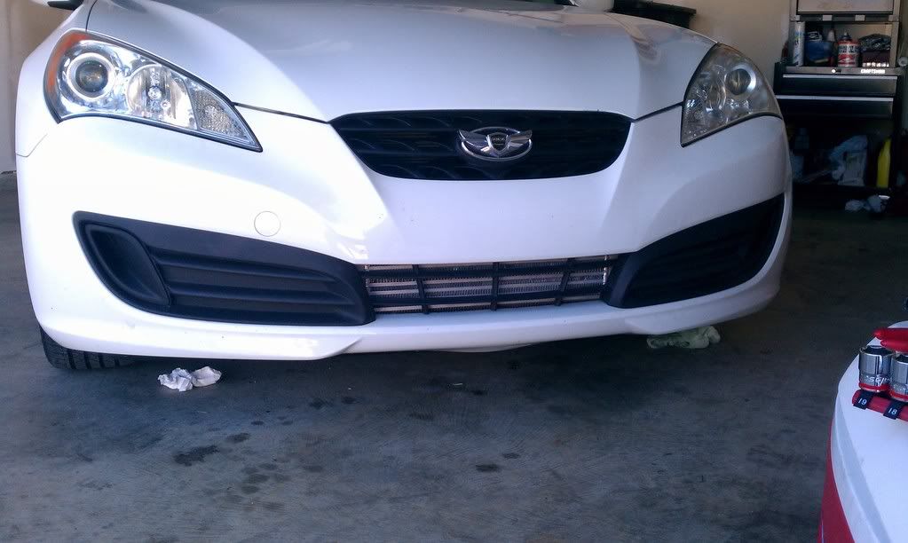

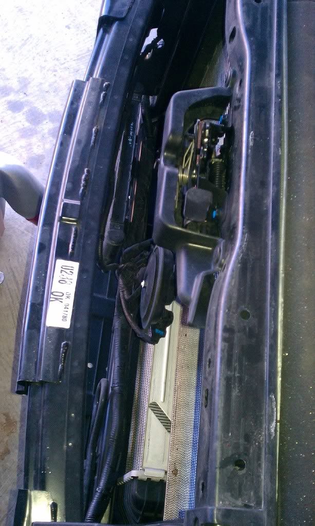

That's really awesome, and great job! The IC looks great up front behind the black grille. The fitment of the filter is perfect, and won't get dirty. If I had a Turbo GC, this is the exact path I would go to.
The only thing I dislike is the AEM sticker. I love AEM, but it may look more subtle and stock without it. IMO stock and subtle rule.
On a side note, I haven't noticed this until now that it really bugs me that the function of the black "vents" on the front bumper are useless. After all of our discussion with function>aesthetic. I really hope they come up with a better front bumper design. I may have mentioned before there is too much plastic and ends up looking cheap and Asian.

The black plastic fog light grills - many people are cutting them out to allow air to pass through, however, with a turbo I REALLY don't want ANY water to get to the blades, that would be bad, so I'm being cautious and haven't cut into them yet.
This isn't warranty friendly, but I shouldn't need it unless it blows up the engine.

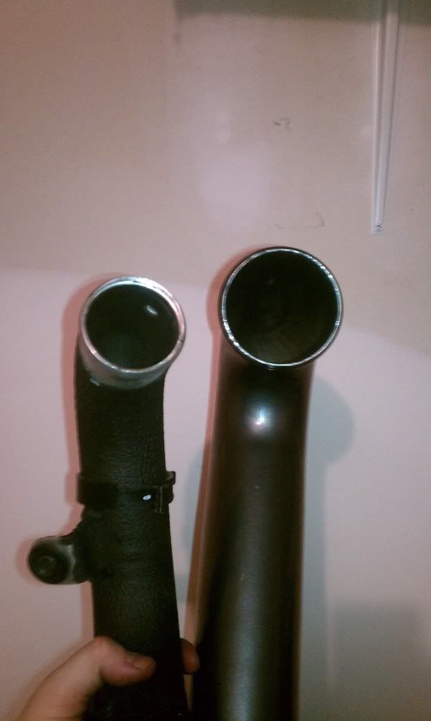

larger pipes altering the A/F ratio, leading the car to perform compensating actions in attempt to correct

even though i saw the pics on facebook, looks good man...i would have painted the intercooler core black to accent the black around the front grill, but regardless it looks good...
Old Feb 2, 2011 | 06:32 AM
lookin good, i would personally cut the strips o the grill out where teh FMIC is. it would look alot cleaner without those little black lines
Old Feb 2, 2011 | 07:30 AM
wow - good to see mwood trolling back here!
optimo - I thought about it, and I actually started to, but it would've required a little dremel action and I was trying to piece my car together. It's still on my mind, though. As easy as it is to remove the bumper, I may do it next time it warms up.
