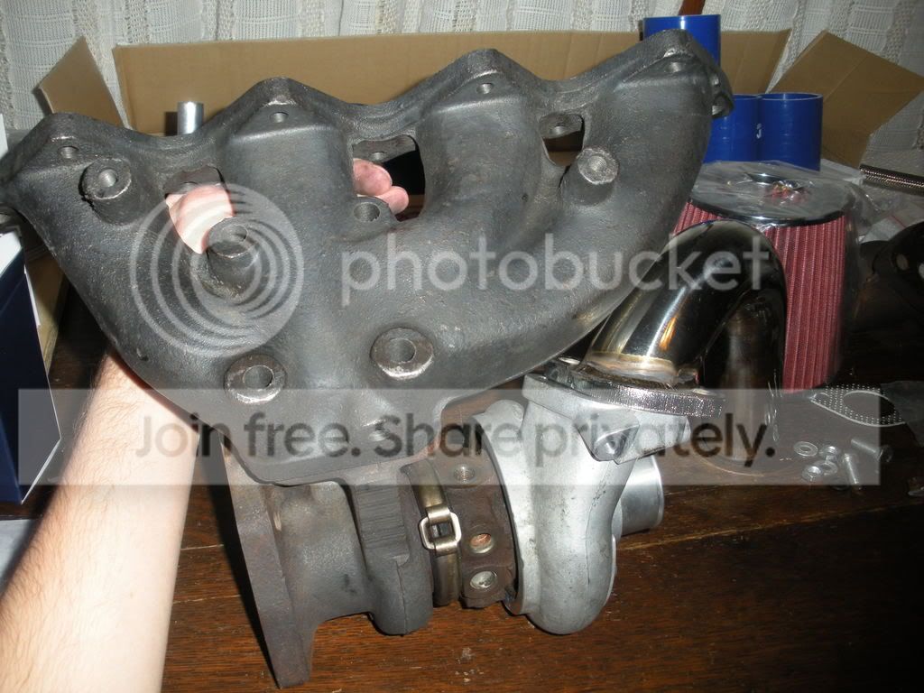

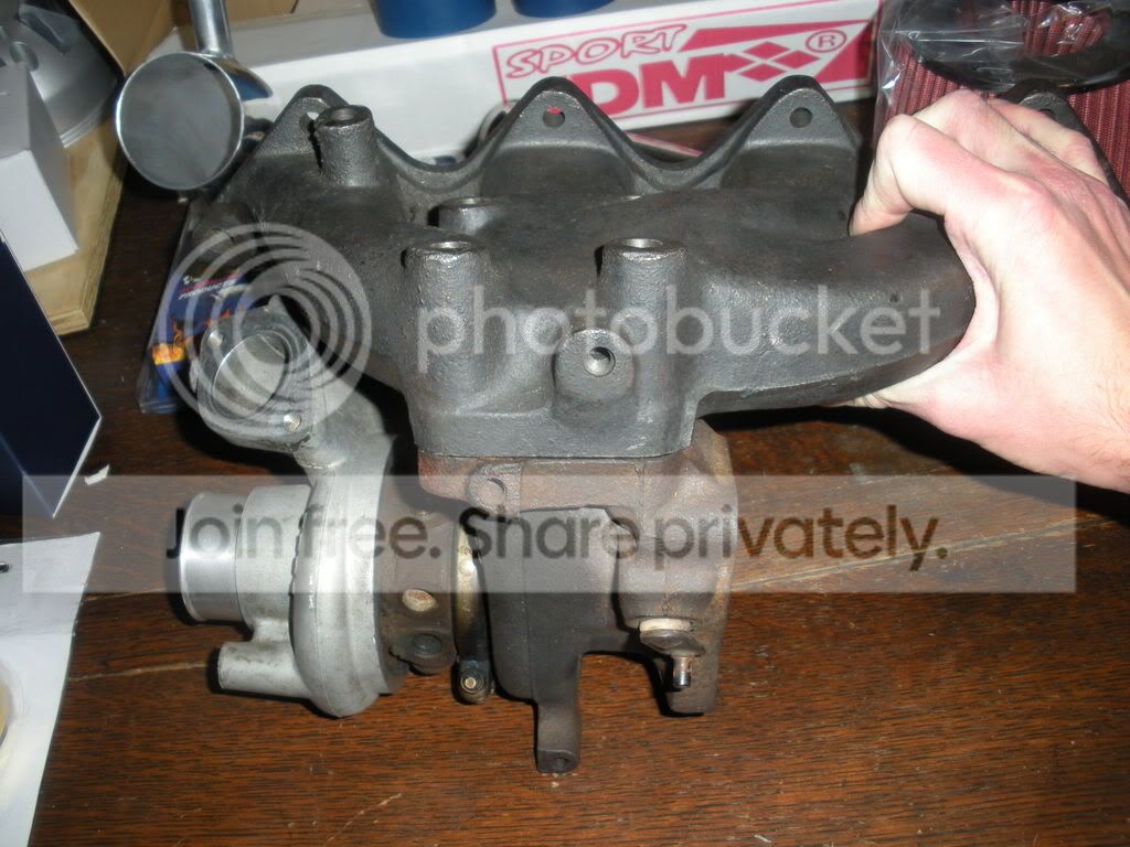

As for the alternator/down-pipe problem some of you have brought up, I don't think this will be a problem because this is how the turbo's going to be mounted\/\/\/
The down-pipe is actually going to be on the other side.

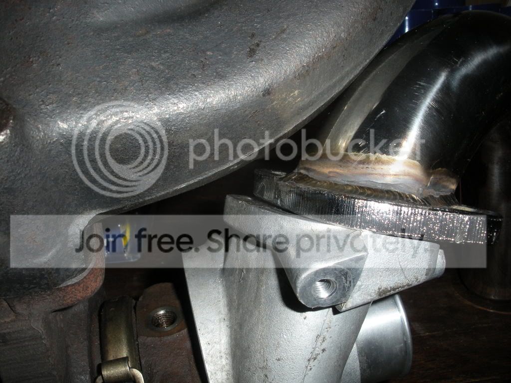

I'd like to mount the turbo like this because I'm pretty sure I could make the d-pipe clear the alt. \/\/\/

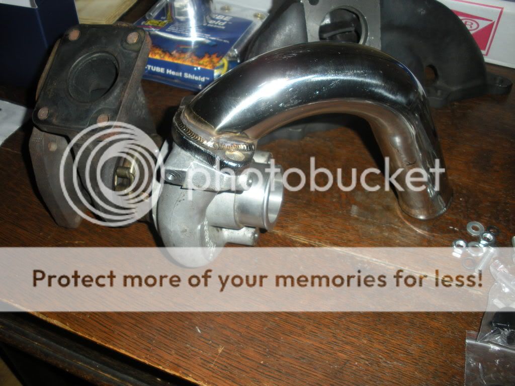

but as you can see the j-pipe would hit the manifold then\/\/\/
Which REALLY sucks because with the cold side of the turbo on the passenger side I'm going to have to remove the power-steering sad.gif

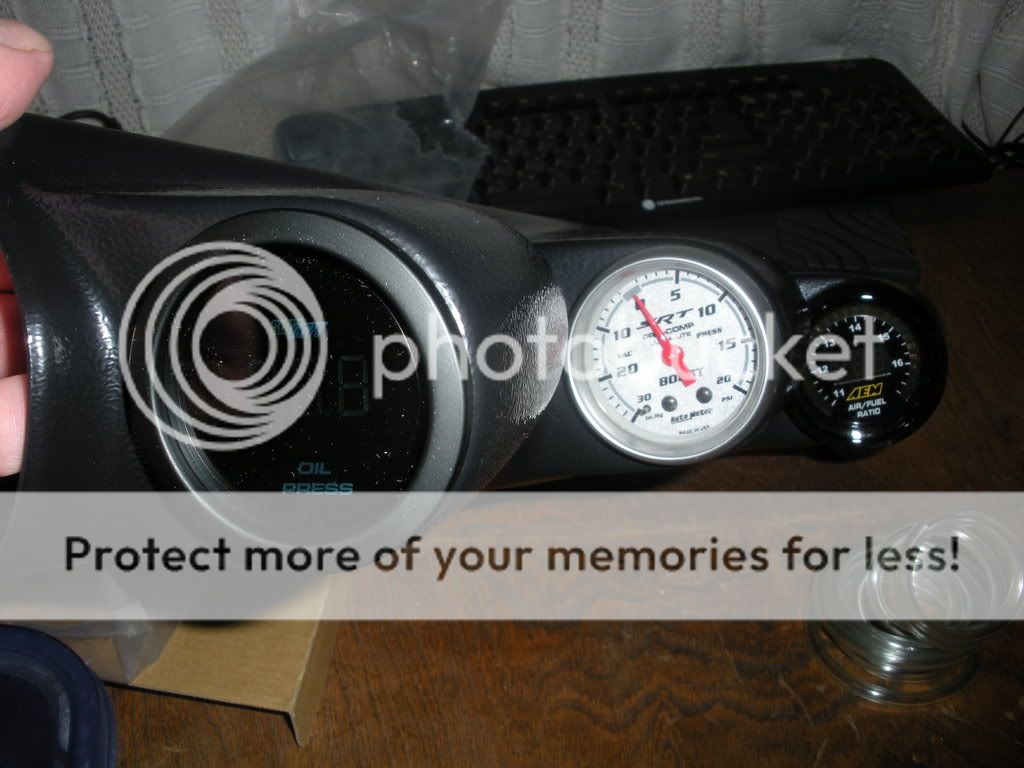

Also, I just got the rest of the parts in today so here are pics.
electronic oil pressure gauge, SRT-4 OEM boost gauge, AEM UEGO wideband, universal triple gauge pillar\/\/\/

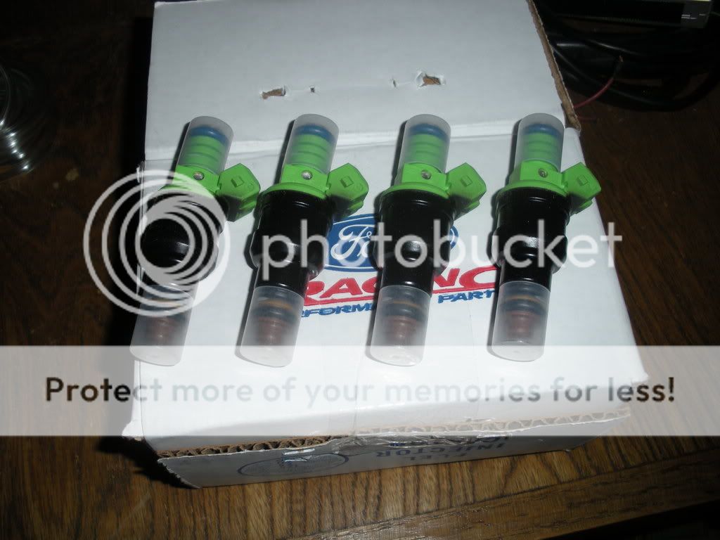

Mustang 440cc green top injectors(I think they're OEM???)\/\/\/
ebay j-pipe\/\/\/

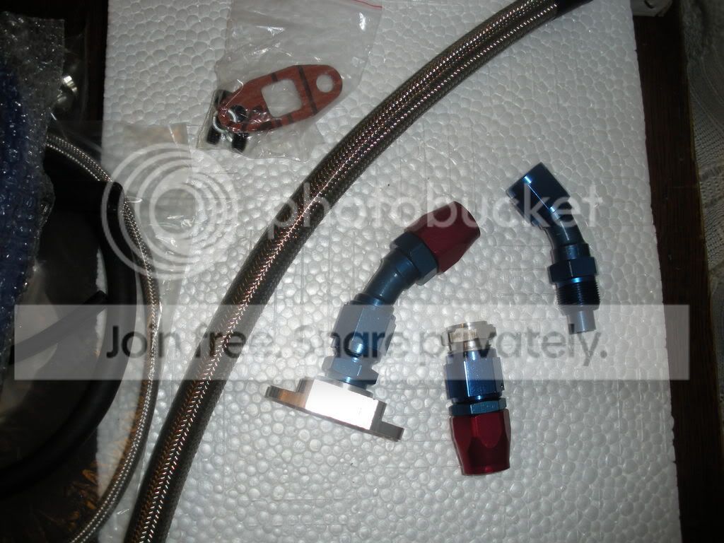

ebay return line and fittings\/\/\/

looks good ... also, be sure to have a Beta exhaust manifold gasket to check the ports on that DSM manifold, they won't line up perfectly and will need some grinding!!!
so good luck with everything, looks like you know where you're going! fing02.gif
BTW, the OEM turbo placement on those manifold is like you show in your first pic : cold side towards the left.
Old Mar 11, 2009 | 08:05 AM
your gonna lose powersteering..... over that turbo and manifold... ugghh..
good luck, doesn't seem like your even saving much money going the cheapo route imo.

What if you just got a spacer for between the turbo and manifold so the turbo sits lower....
Maby it would clear and you could keep it that way and not loose power steering?

^^ the J pipe goes back further than the manifold does, so it will be inside the engine lol.

Well in that pic its at an angle...but it does seem like the cheap way has become the hard way....
