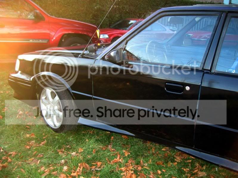

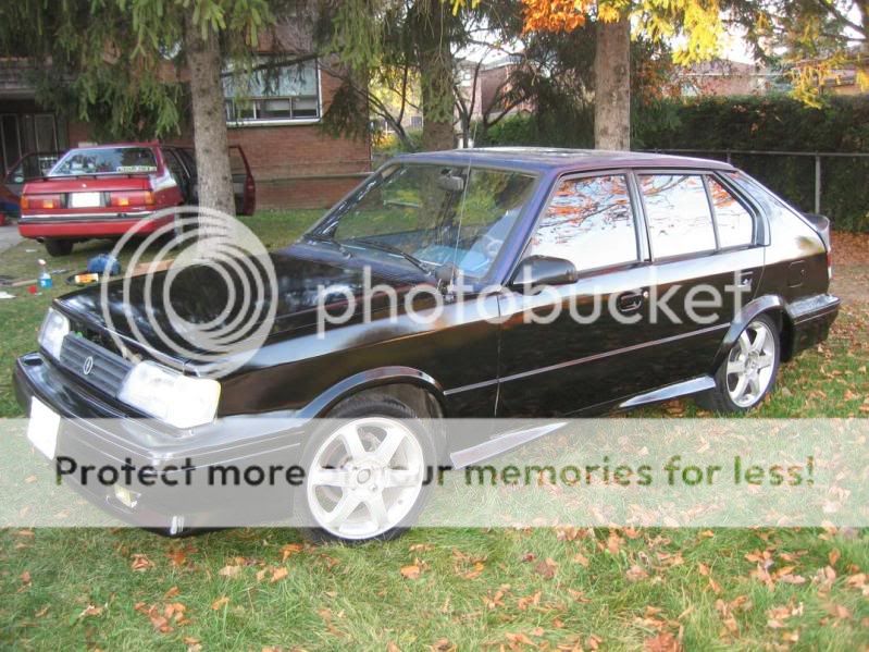

I drive a 1987 Hyundai Pony (I've had 11 so far) which started out like this:
which now looks like this:

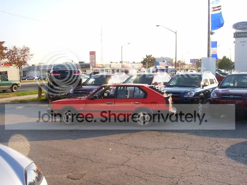

Here's my 2nd favourite Pony:
Assembly line:
The red Pony (the blue one was what the black one was)
