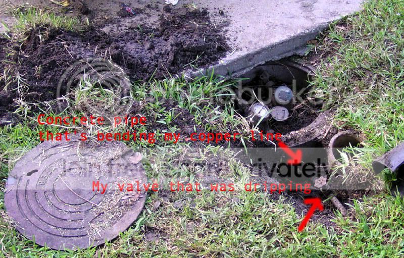

The spinning water meter, with the house shut off: not a Good Thing.
The valve to shut the supply by the meter: dripping. Tightened the packing and it stopped.

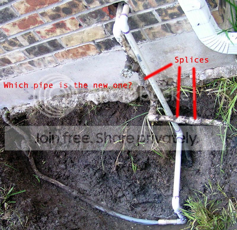

The copper line running from the meter: being impinged upon by the concrete meter pipe, but not broken yet
The PVC feed from the water softener to the house: dripping from a cracked elbow and spraying in 3 places from a broken adapter.
Note to the previous homeowner: when you splice a repair into the downpipe, add length so the horizontal bits stay buried to avoid freezing in the winter. Also, if 3 feet of pipe has 4 splices and an unnecessary part, consider replacing the whole thing (like I just did last night).

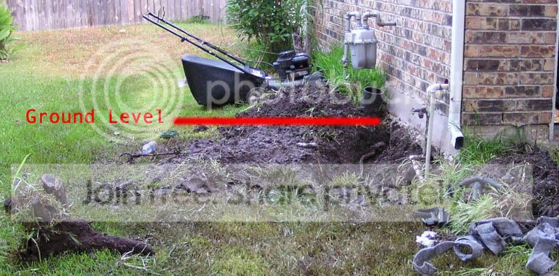

If you ever have to dig out pipes that are buried in clay, backfill it with sand, not the old clay and the next time somebody is down there they will be thanking you as they dig out wet sand instead of wet clay that you can't even get off the shovel with another shovel.
