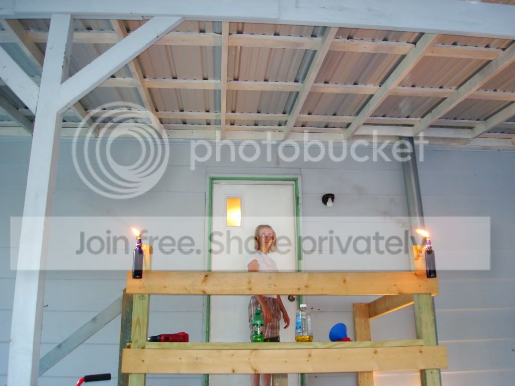

I wish we had a deck or fence where we could use something like this. These are pretty sweet

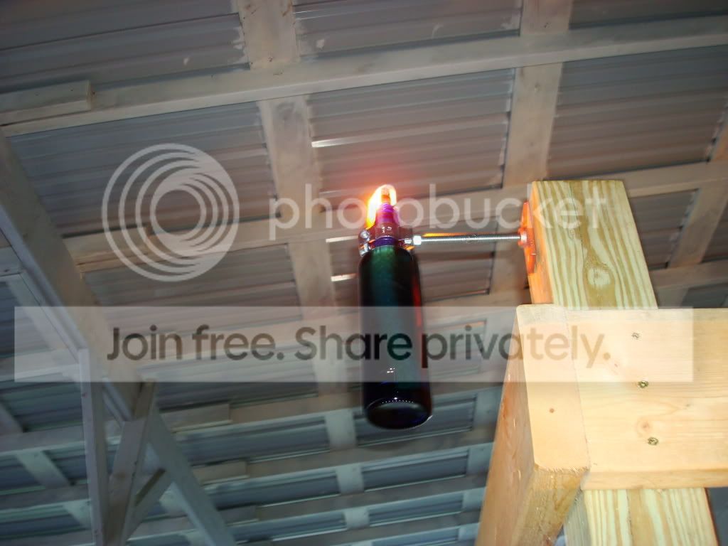

Look great man, can you get some closeups of your clamps?
WHere did you get your parts? Any issues with it?>

I've got one issue with it right from being perfect.
I have no neck ring on these skyy vodka bottles so they can slip out pretty easily. I torqued the piss out of them with the bottle clamps and plan on making a strap that holds the bottom of the bottle tomorrow.
I couldn't find the actual clamps for the bottles like in the diy but these will work when i get the "L" hangars to hold the bottom of the bottle.
i got all the parts from home depot.
top plate connectors are sioux chief brand. copper clad. part #541-cpk2 $1.05 a piece.
3/8"-16 allthread cut to 5 inches lg. 24" stick cost 2 bux.
the bottle connectors are 3/4" conduit strap hangars. 1" was too big and 3/4" was a bit small but they dont make 7/8".
all the copper pieces are EPC brand which they had tons of.
