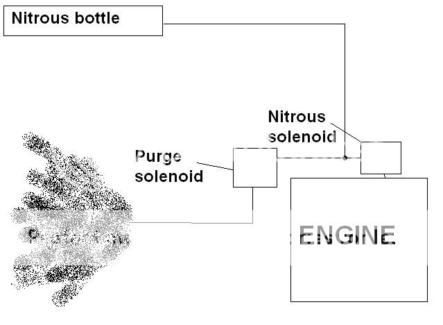

Alrighty. I've got the NX Mainline EFI kit sittin in my living room. Ironically, I'm sitting on the floor beside it - metaphorically poking it with a stick. So here's the question to the nitrous gurus of our beloved forums. The GENX-2 accessory kit from NX is reaaaally attractive, however, upon closer investigation, the purge says it is only for the 'iceman' solenoid. now my solenoids prrretty apparently say 'MAINLINE' right across em. question in point - which purge kit/valve will be compatible with my Mainline kit? thank you very much in advance. have a nice day. smile often. and don't put your nose where your finger wouldn't go.
Old Oct 8, 2008 | 03:41 PM
I'm not familiar with that kit. A purge is for purging the lines up to your nitrous solenoid, it has nothing to do with the solenoid itself. I'm not familiar with that speciffic manufacturer though. Try the ZEX nitrous racer's kit.

^^ What? You asked a question and you were answered....
Ok, does this help?

The purge uses a -4 fitting to connect to your nitrous solenoid. I'm fairly certain that all the kits will have this size plug on their solenoids and the purge kit is a universal fit.

awesome! thanks both of you. sorry for the confusion dtn, but your map-thingy-ma-jiggy helped alot. and jon - that was the answer i was looking for. again, thanks to both of you. now if only you could get me out of kentucky, i'd give you both high fives. ^ ^ thanks again. oh. and PM sent buuuuddy
