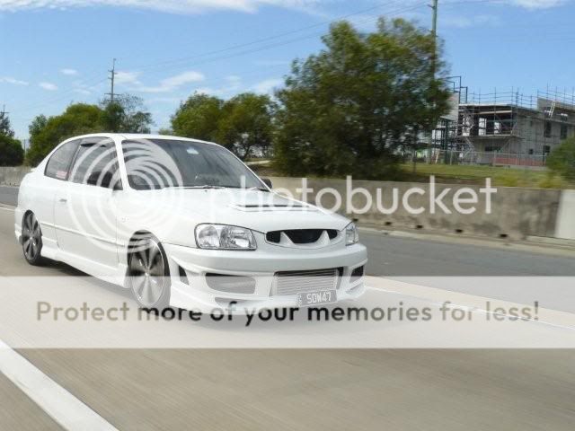

only just found the site wen i was on hyundai performance. my name is ian i drive a 2000 hyundai accent gs turbo. alot of custom work and its my pride and joy its not comptely finished but i'm gettin there

Your Accent looks wonderful! I'll bet it's a lot of fun to drive too. smile.gif

That is a very clean looking car. Welcome!

HOLY CRAP!
That's one good looking accent!

Welcome. That is one sweet Accent.

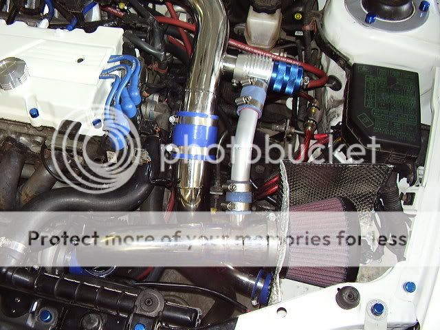

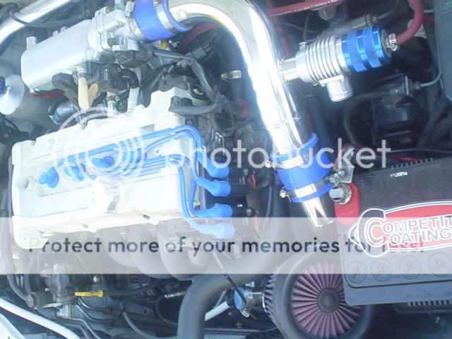

this was before the battery was in the boot
and seen as the police didn't like were the air filter was i moved the battery to the boot and made a new pipe up and the bov is plumb back

How much did recirculating the BOV back to the intake quiet it down?
And nice to see that someone noticed that the BOV is open almost ALL the time and didnt want dirt inside their engine. Nobody catches that ever... lol

"Bypass" valves are... BOV's aren't. A real BOV only opens one way.
Anyways, nice Accent. I like that you re-circed even with a MAP sensor. Recirculating helps keep the turbo spun up when you close the throttle. You have any internal work done or is this a fairly low pressure set-up?

the bov is actually very loud i have put a tighter spring in. but i still got pulled over by the police cos they think its atmosphere lol. i'm still running stock internals just 6psi makes about 150hp. lots of fun to drive but i'm lookin into gettin new pistions and rods and some head work and makin it so that the engine won't break.
