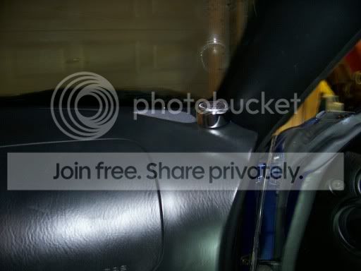

heres what i did. on mine, i had the stock tweeters up in the corner of the dash(crashpad), right where it meets the corners on each side. i just took them out and got rid of them.
i bought polk 6.75 components to replace the entire sound system in my car, front and back. on the backs i made an adapter plate for the woofer and used the flush mounts for the tweeters and mounted them in the rear quarter panel trim peices, right behind the quarter windows. i mounted the crossovers right underneath the rear seat bench; one behind the driver seat and one behind the pass. seat.
for the fronts, i used the surface mounts for the tweeters and molded them to the side view mirror interior covers; the little triangle peices. ill put some pictures below. the woofers fit into the stock speaker bracket things fine. i put the crossovers in the map pocket of each door. \
you can get more info in my "many many mods" thread, somewhere in interior i think. its like 3 pages long. here are the pics of the tweeters....

That looks nice man. I think I can manage that. Get's my modding vibes going smile.gif . Gonna check out yer thread.
