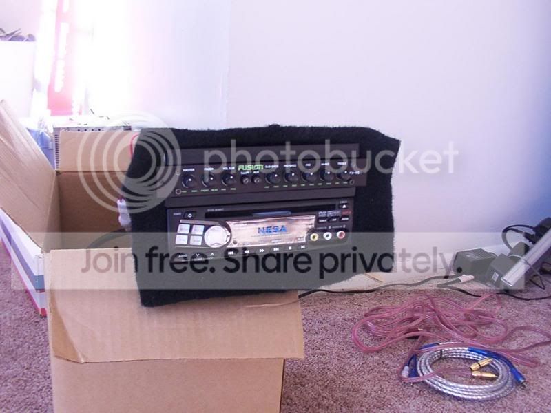

So I got this half din active/EQ/line driver thing, and wonderfully sexy she is too.
But the problem was my dash. Let me rewind a bit.
When I got the car there was a Sony (eww eww and double friggin eww) in there. Now it was a nice head unit but like every other sony the person who designed it forgot to add any bass.
Almost like the guys at JVC who also have no idea how to make a f***ing head unit.
Look Mr Corporates, leave it to the professionals huh? (Alpine, eclipse and so on Denon being my favorite)
So anyway, at the time I got the Tib I was a bit of a lowly pauper. So I got a Infinity Din out of an 04 and set to work with a dremel, large set of pliers and a hacksaw and made it fit. The problem was when I reverted back to using a single Din I had all kinds of problems getting it back in there, cue the duct tape and so on.
So I knew that the Active etc was going to be a problem hence why I have been putting that off and favoring other things.
Anyway this wednesday is the day of truth, and probably the last day with any kind of warmth to be kneeling on the ground running RCA's (I have to run 3 sets to the trunk.)
So I had a few great ideas here, and Im proud my brain came through today.
Idea # 1 - To set the active up above the head unit so I didnt block any vents I used some motherboard mounting things (the brass ones) which were the perfect height for that.
#2 a chopped stereo strap and some dremel work held it in place.
#3 an old single din cubby hole thing (those scosche things) attacked with the dreemel made some nice filler strips to bring it to full din.
#4 I remembered that the head unit had gaps around it when in the dash. It wasnt bad but I am a perfectionist. So this was where I hatched the best plan, and one that will stop coffee that spills from going inside the dash.
I made a carpet 'skirt' using some leftover acoustic carpet.which really finishes it all off nice and covers any tell tale brackets and stuff you might normally see.
This isnt fully trimmed yet because I have to do that in the car, but piccy shows how tidy my little dashoard stack will be smile.gif

yeah the output gains are on the front, as in pic. but the input ones are on the top.
