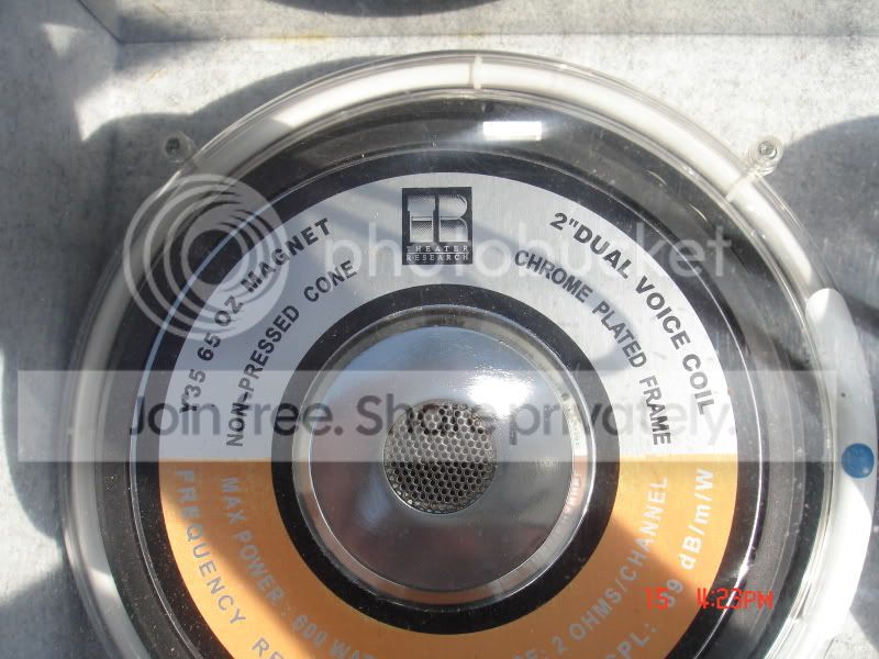

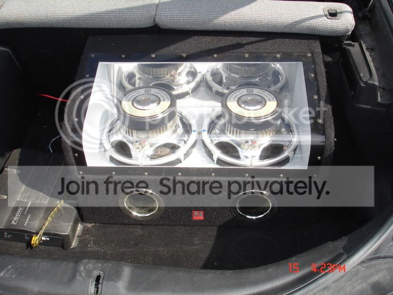

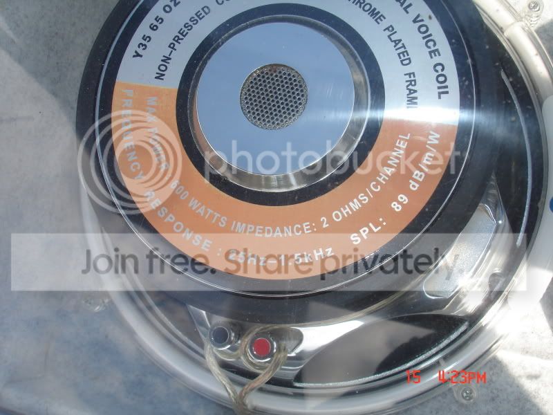

What I'm thinking is picking up a yellowtop optima for power, one of the nine.2s to power my dual subs(I need to check ohms and such for compatibility). Then I'm seeing audiobahn speakers 6.5s and 6x9s all over ebay for 50$ a pair. If anyone can give me a model number that isn't the dirt cheap crappy quality ones, that are plastered all over there, so I can get an idea. My original amp is a 2 channel, but it has an input for 4 way in the back. It's a 760W Pioneer (http://www.walmart.com/catalog/produ...uct_id=4891521) Yes that is a wal-mart link lol, but it googled well. I'm going to take a quick picture of the subs and show them to you. They were a gift from my mechanic.

Sorry for the big pictures, last two show the text on the speakers.
