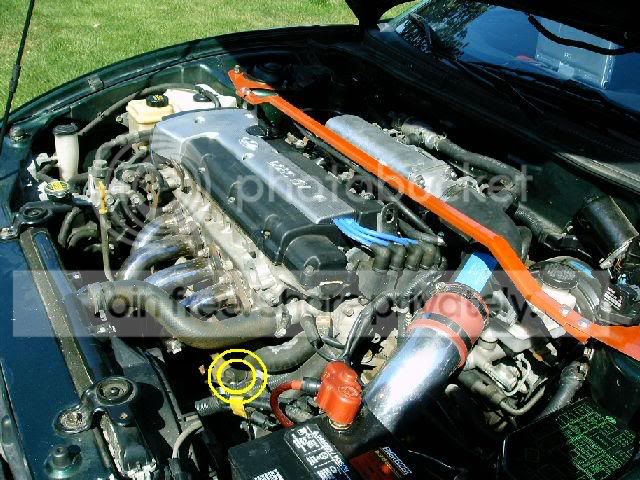

My oil pressure reading is the same.........about 5-10 PSI at idle when my engine is at running temp, and then anywhere between 25 - 55 PSI when cruising (depending on RPM's).
Here is a pic of where i hooked mine up. Where else can i hook it up....to maybe get a more accurate reading.
That's using 10W30 Synthetic Oil.
Old Nov 15, 2005 | 10:44 PM
tanc's Avatar
Posts: 5,754
Vehicle: 1997 Tiburon
Right here where your stock oil sender, right next to the crank sensor.
Old Nov 15, 2005 | 10:51 PM
xtremeskier's Avatar
Joined: Oct 2005
Posts: 515
From: Alberta, Canada
