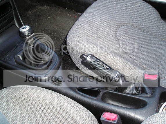

Mad Machine is right, there's a little rubber ring that slides in between the shaft and the handle. Its a seperate piece that you have to buy, but its only like $6. I went to my local speed shop and ordered one, I think it was actually listed for a civic, but it fits fine. I also used a black zip tie at the bottom to fully secure it.
You can kinda see it here, its black, inside the chrome...anyway once you get the thing on, you'll love it. I love mine.
