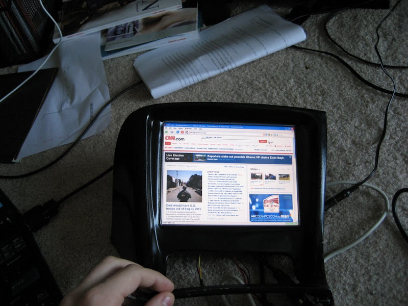

The screen - $200
I am using the VM80b screen, got it off ebay. You can go with better brand (like Lilliput) but it will cost more. This one has worked well so far and is very visible during the day.
http://www.short-circuit.com/product/VM80B.html

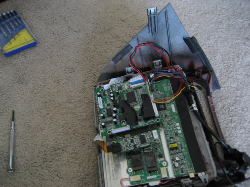

It is molded in the radio surround; (I bought the surround already made for this screen from a member here). I took the screen apart, and there were different separate boards inside it. Some of them I didn't need (buttons, inputs other than VGA). The others I mounted on the back of the screen by gluing some plastic mounts. It was a bit of work, and you need to be careful to not screw anything up.
The screen comes with a remote control, and you can separate the IR sensor from inside the monitor, and make it that it sticks out near the cig lighter. That way you can still use the remote control to control brightness and whatnot.
