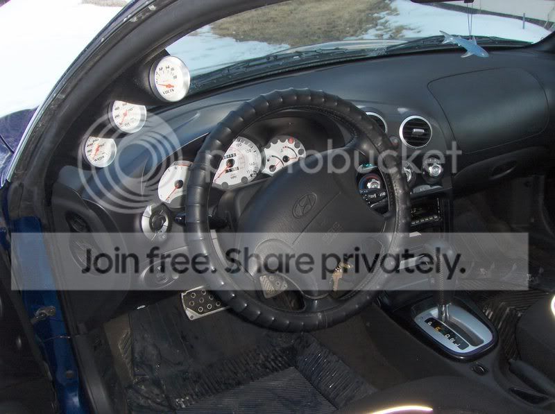

Nice work!! You going to start these in production? laugh.gif At least post a DIY or something.
Old Mar 2, 2007 | 11:22 PM
you made like molded that yourself?! that's excellent! is your car boosted or what?

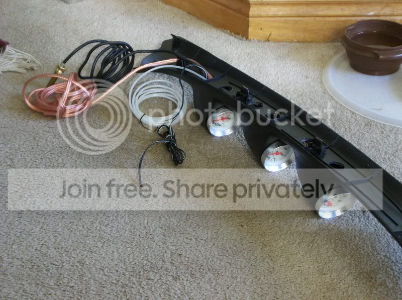

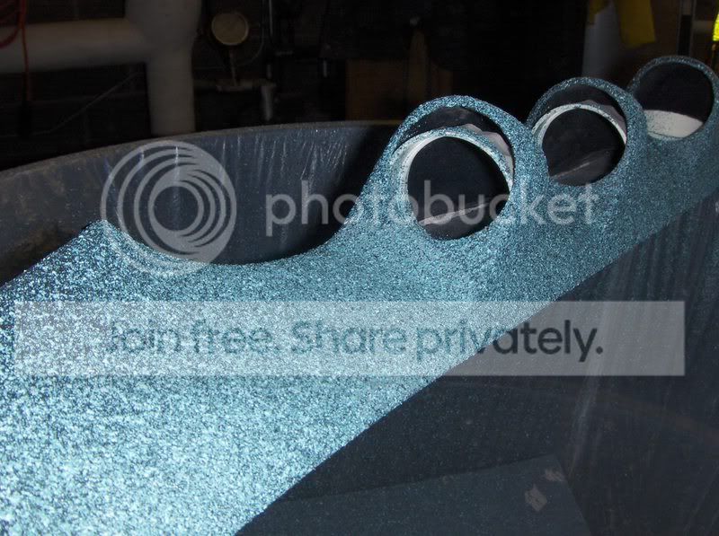

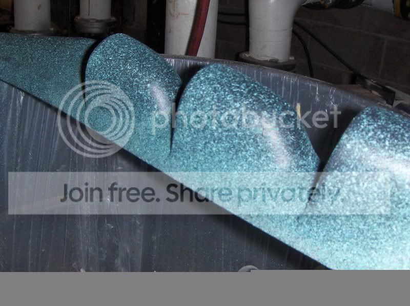

I'm pretty much stock,these are just voltage,oil,and water pressure guages ,For texture ,I used green KRYLON /make it stone textured spray paint, (spray on,rub off bumpy cooties with bare hand,reprime,and paint with black Dupli-color Vinul & tissu paint from CDN tire store.I should do diy for this,my subs,and my clear door lenses!

What did you use to attach the pods to the pillar? was is just bondo, or did you use screws, or what? Also, where'd you get the gauges for, what kind are they, and how much $$?

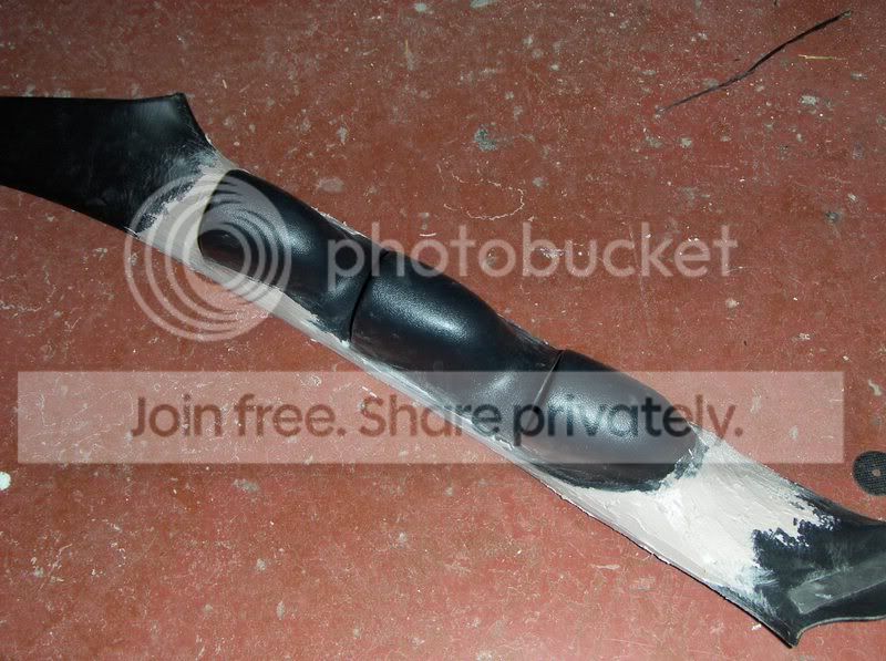

are these pods wanted that bad? its really not that hard to do. just mold sand etc. just do thin layers and sand with precision. oh and what i recommend is instead of screwing it in use pop rivits. its all the same.

this is what it was http://cgi.ebay.ca/11-99-ABS-UNIVERSAL-TRI...1QQcmdZViewItem , I used a heat gun to help shape it better,a dremmel to carve it the pillar shape,then 4 pop rivits,body fill,and a lot of sanding.
