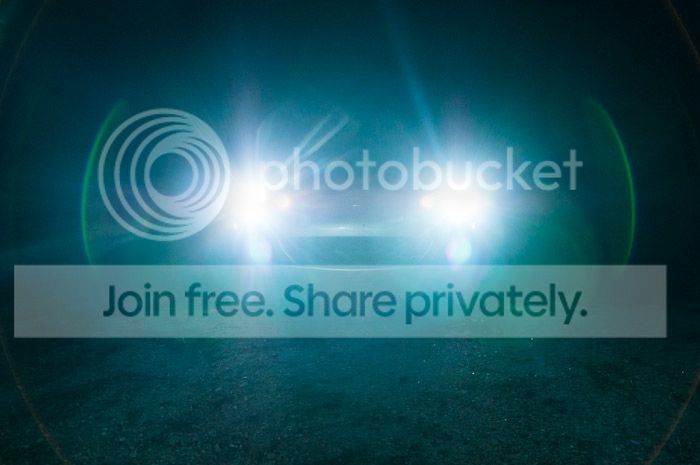

Yup DDMTuning HID's in my 2001, for low beams only. The only thing that bothers me is I had to cut a hole in the cap on the back of the headlights, but its really no big deal they still seal fine.
35W 6,000K bulbs No need for any of the extra things like the mounting kit/error free/adaptor kit. Just use some nice double sided tape to mount the ballasts.
Old crappy picture, 10,000K Low beams with Silverstar Ultra high beams. non of the current 6,000K bulbs
(http://i849.photobucket.com/albums/a...y/3e09b548.jpg)
